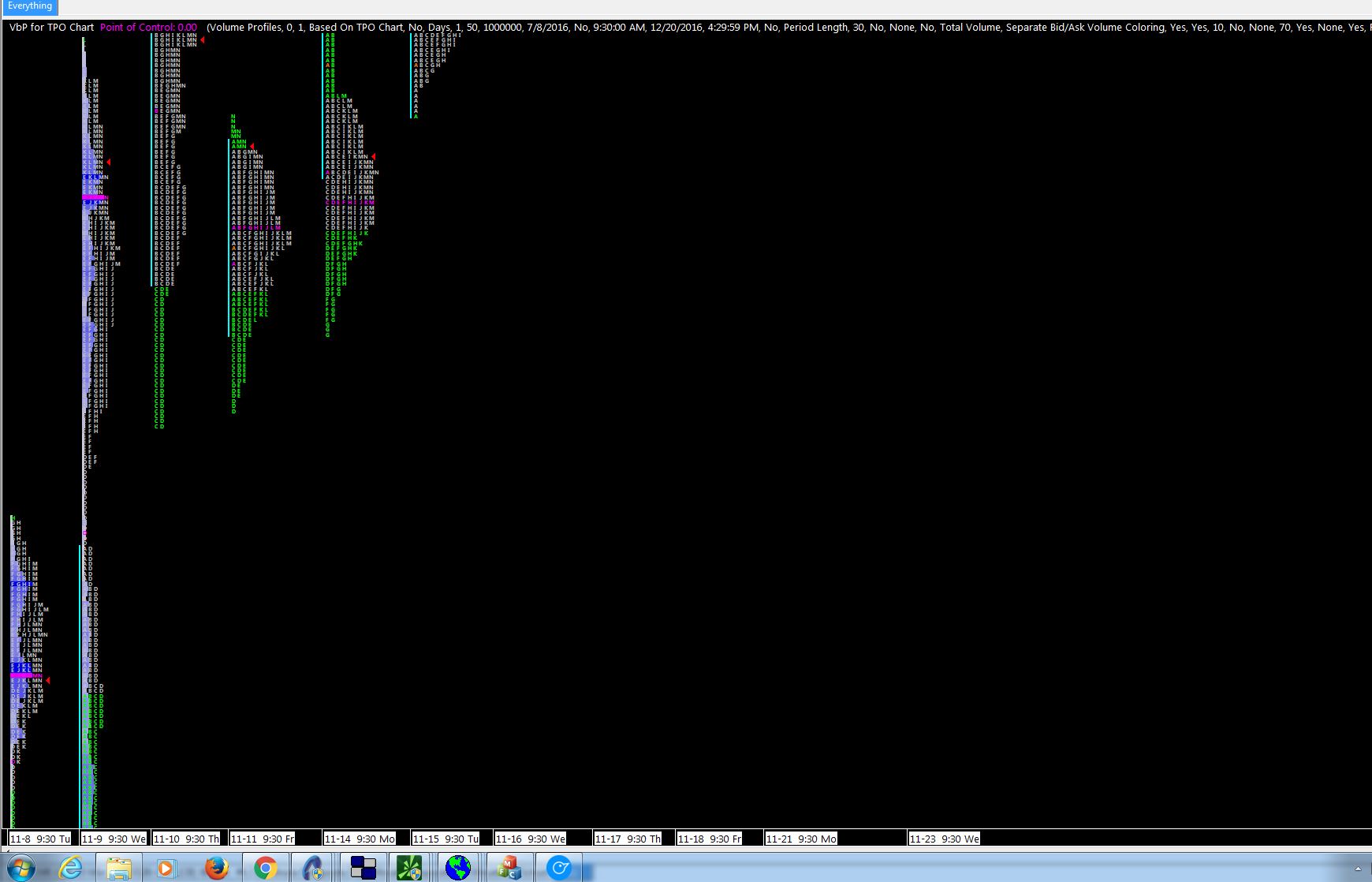

For some reason the VbP Study is only filling in the one or two TPO profiles at the leftmost side of my screen. Any ideas why it's doing this? Thanks.

How are these 2 inputs set:
http://www.sierrachart.com/index.php?page=doc/VolumeByPrice.php#Input_SetAsIndependentVolumeProfileForTPOChart
http://www.sierrachart.com/index.php?page=doc/VolumeByPrice.php#Input_VolumeGraphPeriodType
[2016-11-23 20:31:23]
User275302 - Posts: 52
The first is set to NO. And the second is set to Based on TPO Chart.
[2016-11-23 20:47:38]
We do not know the answer to this unless we get the Chartbook containing this chart from you.
Okay, here... it's the TPO chart, obviously

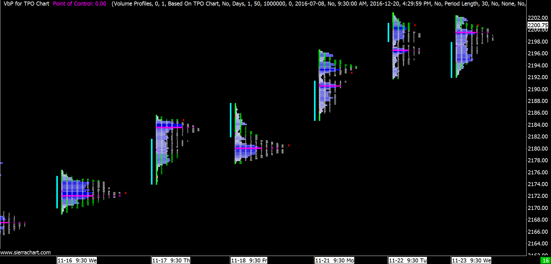

OK we finally found the chart.
We reset the scale with Chart >> Reset Scales because at the time we looked at it, we could not see anything.
This is what we see:
http://www.sierrachart.com/image.php?Image=1479935806815.png
We recommend re-downloading the data in the chart in case there is missing volume data which would seem unusual though.
Re-download the data with Edit >> Delete All Data and Download.
[2016-11-23 21:26:29]
Okay, so... sorry, I don't understand what the solution is exactly. I reset the scales and re-downloaded all data but I'm still not getting the VbP except on the TPO profiles on the far left of the screen. Thanks.

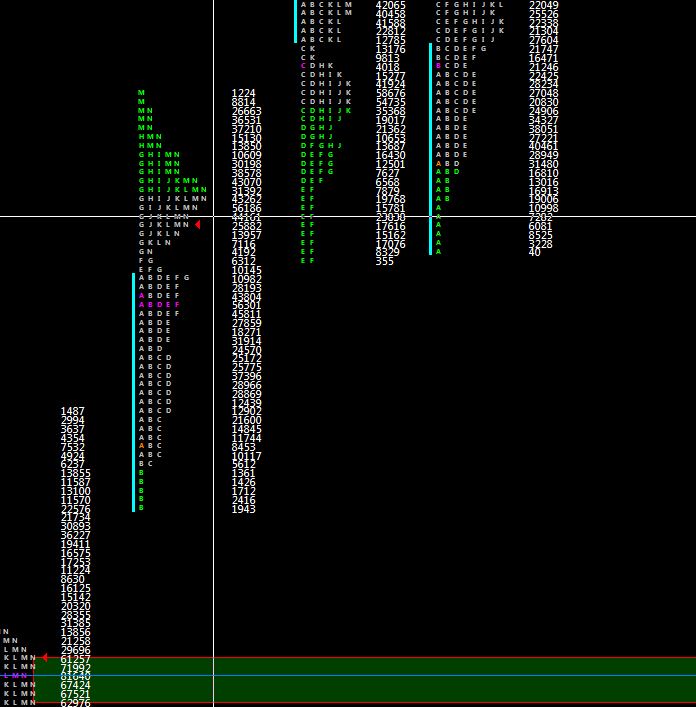

Okay... when I clicked Reset barsize/spacing/scale - I got what you got. Is there any way to make the numbers smaller on trade volume on the VbP? What about font color of the volume numbers?
Nevermind... founnd it, got it.

For the answer to the question, refer to the input description here:
https://www.sierrachart.com/index.php?page=doc/VolumeByPrice.php#Input_DisplayVolumeInBars
We are not sure why you had the original problem. As engineers of the program, we do not know what would have led to that. We could not reproduce.
This is good but we are not sure why this happened to begin with.
