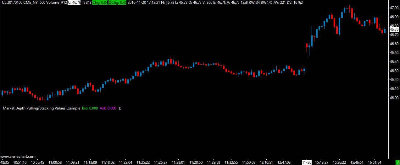

[2016-11-21 01:29:59]
Mistic - Posts: 76
http://www.sierrachart.com/image.php?Image=1479690802533.png
I added this to the top of the example:
#include "sierrachart.h"
SCDLLName("Stack Pull")
I've tried the example and can't get any values. I even tried declaring the function 2 different ways to see if that was needed and still can't get it to work. My trading DOM combined stacking/pulling column is working just fine. Any suggestions as to whats missing or why this doesn't work?
thank you
Date Time Of Last Edit: 2016-11-21 01:31:22
[2016-11-21 02:15:02]

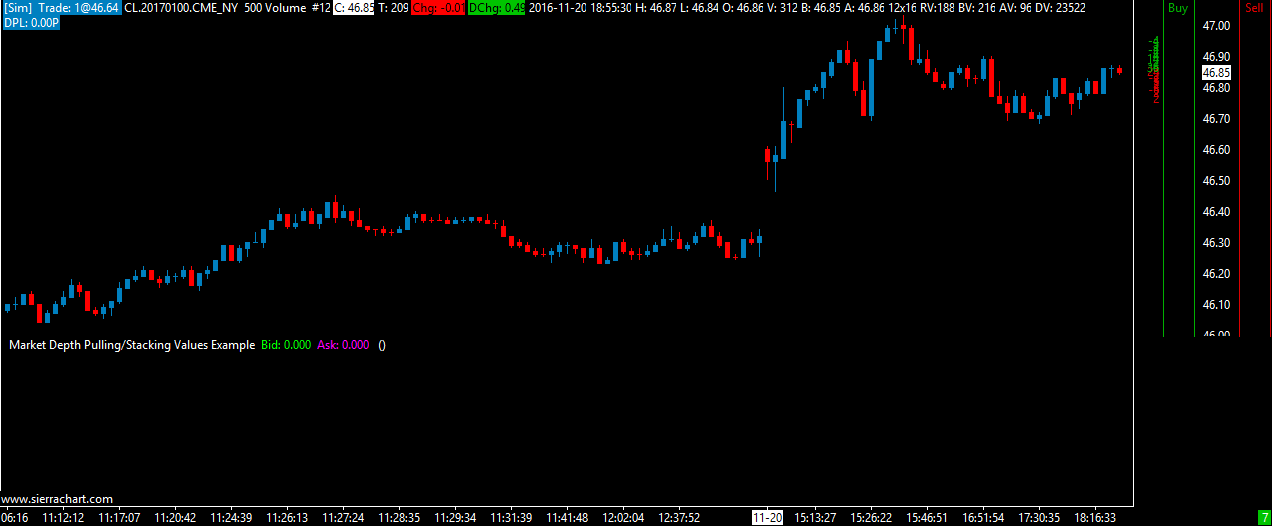

[2016-11-21 02:58:20]
Mistic - Posts: 76
It did not fix the problem. I enabled trading DOM on and as you can see from my chart image, the pulling/stacking column works and is showing.
http://www.sierrachart.com/image.php?Image=1479696942676.png
[2016-11-21 03:05:37]
Actually thinking about this some more, it does not matter that the Chart DOM is enabled on the chart containing the study using those functions. It only matters that there is at least one Chart DOM displaying this data but it can be in a different chart.
It is clear what the problem is now. It has to do with the fact that you are using CTS and there is a price multiplier. We will fix this later today.
Date Time Of Last Edit: 2016-11-21 03:06:06
