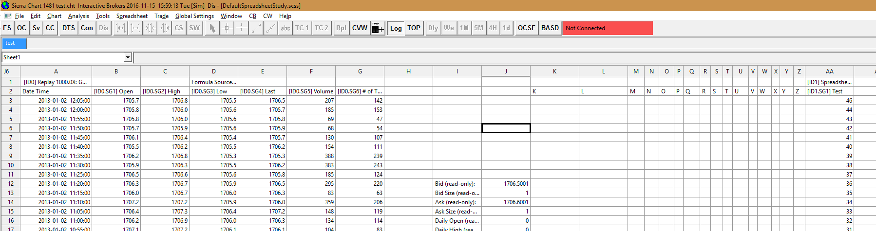

I have a problem with missing data for my custom studies in spreadsheed generated by spreadsheetstudy. The difference is that the one before last bar is missing in scss (see attached images) making whole data off by one bar.
The problem is probably caused by one of following settings in study (as that is pretty much all that is there):
sc.CalculationPrecedence = VERY_LOW_PREC_LEVEL;
sc.MaintainAdditionalChartDataArrays = 1;
sc.MaintainVolumeAtPriceData = 1;
Result:
2013-01-02 12:05:00 46
2013-01-02 12:00:00 44
2013-01-02 11:55:00 43
Expected:
2013-01-02 12:00:00 45
2013-01-02 11:55:00 44
SierraChart version 1481

[2016-11-15 19:13:34]
wat - Posts: 67
Please check attached images. The data ouputted by Spreadsheet Study is not same as in graph for some settings of custom studies (from what I tested).
Last bar is correct. The last-1 bar has incorrect value in produced spreadsheet (having value of last-2 bar). As for 12:00:00 there should be value 45, instead of 44.
This seems like a bug of spreadsheet study (because chart data are correct).
Provided testing study just increases value by 1 for every bar. To see it more clearly that in scss there is difference by 2.
[2016-11-16 03:27:49]
The data outputted by Spreadsheet Study is not same as in graph for some settings of custom studies (from what I tested).
This is a calculation precedence/order issue.
This is documented here:
http://www.sierrachart.com/index.php?page=doc/ChartStudies.html#StudyCalculationPrecedence
There definitely is not a bug in the Spreadsheet study. That is not even possible.
We have seen the kind of issue you describe before. And the cause is as explained.
