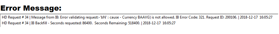

Sorry, I don't trade ES but was just using that as an example, I'm not familiar with its contract months. So I entered the IB format and it works without adding BAAVG. But when I add BAAVG I get an error message (see screenshot), obviously because IB doesn't recognize the BAAVG suffix. Any way to fix this?
This Works: {CL-201901-NYMEX}-{CL-201902-NYMEX}
This Doesn't: {CL-201901-NYMEX-BAAVG}-{CL-201902-NYMEX-BAAVG}

We need to see why using that suffix is causing this issue.

We did verify that the recording suffixes do work properly:
Supporting real-time market data updates for child symbol: CL-201901-NYMEX-BAAVG | 2018-12-26 19:26:15
Interactive Brokers | Starting real-time market data updates for: CL-201901-NYMEX. ID: 1 | 2018-12-26 19:26:15
Interactive Brokers | Subscribing to Symbol: CL, SecurityType: FUT, Expiration: 201901, Exchange: NYMEX, Primary Exchange: , Currency: , Multiplier: , CallPut: , Strike: , LocalSymbol: , TradingClass: | 2018-12-26 19:26:15
Interactive Brokers | Requesting security definition data for: CL-201901-NYMEX. ID: 1 | 2018-12-26 19:26:15
Symbol Error - CL-201901-NYMEX is unknown, unavailable, or improperly formatted. No security definition has been found for the request | 2018-12-26 19:26:15
But just wait for the next release before testing again. But there should not be a problem in version 1853.
