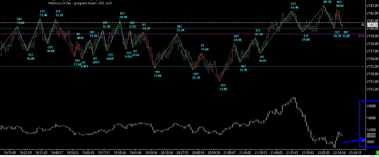

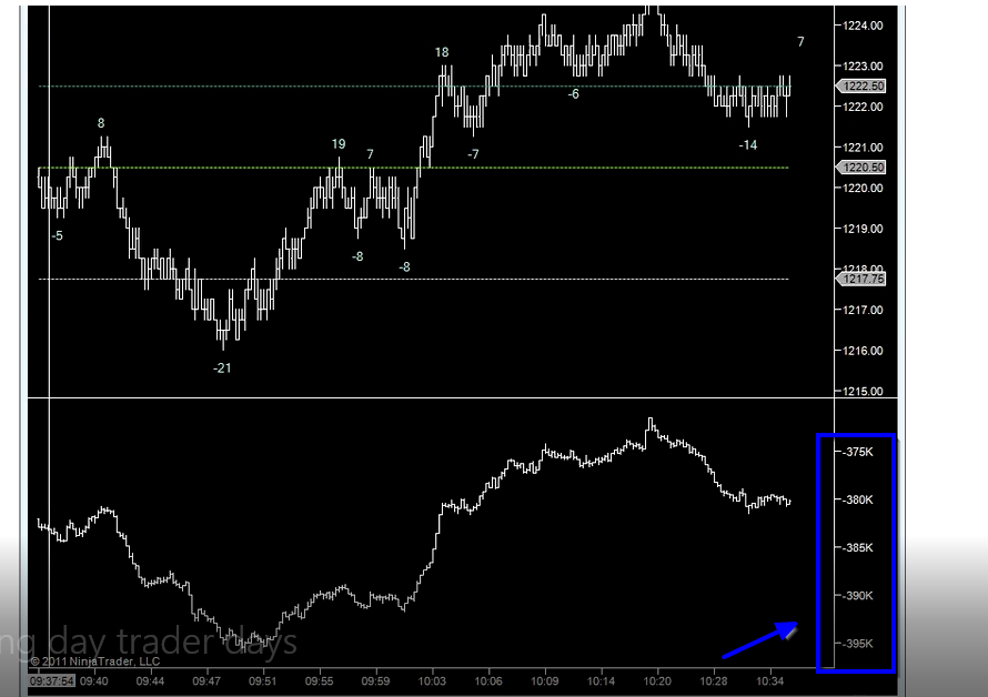

I have seen and a course i have been in uses Ninja trader and the cummulative delta he uses is Gomi cummulatice delta which is a seperate vendor. But the question i have is the following:
He guages and gets info by the movement in delta shifts that he sees in the value window on the right. for example he will say a move off the lows and increase by 10k could indicate that a change is trend is now happening.
I am wondering how i can replicate this or which cummulative delta study in sierra i should use, because none of them have the same digit value as his but wondering if i can still interperet the ideas in the same way.
Here is a example.
so the first picture is his as you see he has a higher digit for the contracts traded amount then my sierra picture But wondering if the change in size will still be the same even though the digits might less.
If so which cumulative delta is best. i am currently using the cumulative delta volume study.
Thank you

Refer to the documentation here:
https://www.sierrachart.com/index.php?page=doc/TechnicalStudiesReference.html#CumulativeDeltaBarsDifferences ( Cumulative Delta Bars Differences)
You need to use the Cumulative Delta Bars - Volume study.
