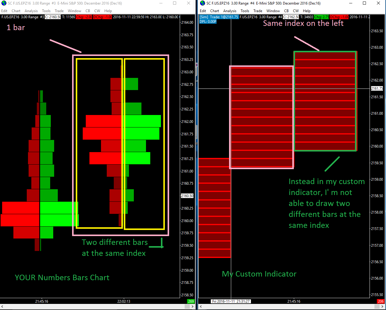

[2016-11-12 18:00:42]
User96015 - Posts: 55
Dear sir,
please look at the attachment.
Thx.
imageSierra.png / V - Attached On 2016-11-12 18:00:35 UTC - Size: 67.81 KB - 474 views
[2016-11-12 20:33:27]
So you want to be able to do 2 Box Top and Box Bottom drawings at the same chart bar and offset them from the center of the bar? So we would need a left aligned and a right aligned version of these.
