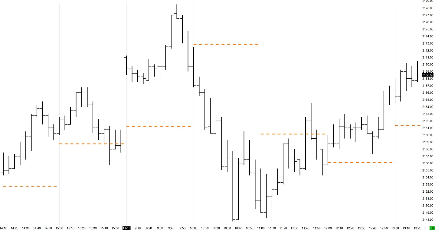

[2016-11-10 18:33:22]
jackw - Posts: 57
You can do what your trying to accomplish without a spreadsheet, although it will require that you keep an hourly chart open in the background.
The attached chart shows what it looks like, and the attached chartbook shows how I did it. Note that you will have to change the chart's symbol to something you have data for.
Of course, This can also be done with a spreadsheet. I sure Tom will post something for you when he gets time.
imageChart1.png / V - Attached On 2016-11-10 18:32:04 UTC - Size: 58.56 KB - 365 views
attachmentHourly Midpoint.cht - Attached On 2016-11-10 18:32:26 UTC - Size: 59.94 KB - 438 views
