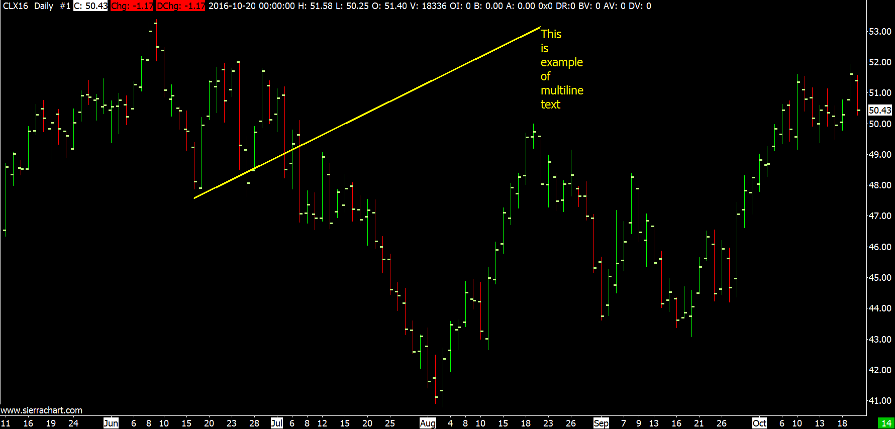

Regarding multiline text for a Line drawing, we confirmed that this does work properly. Here is an example set with the Modify Text command:
http://www.sierrachart.com/image.php?Image=1478254204739.png
