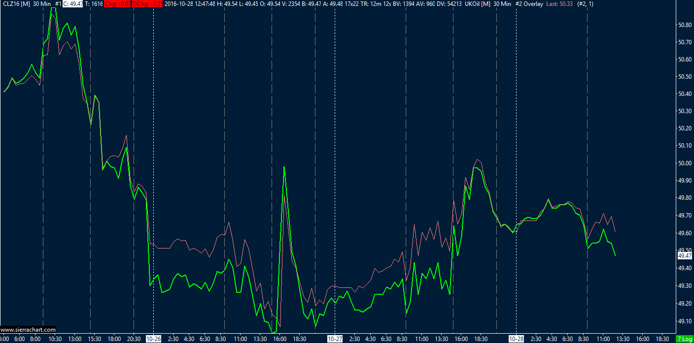

Is possible to have WTI + Brent in one chart/one window to see realtime spread?
I tried Overlay (Bar) study, but it shows second symbol in the second region.
Also tried change the second region to the first region, but I´m getting kind
of nonsense data - see the screenshot. Green line is WTI, red line is Brent.
Brent should be higher than it is.
Thank you for your help.

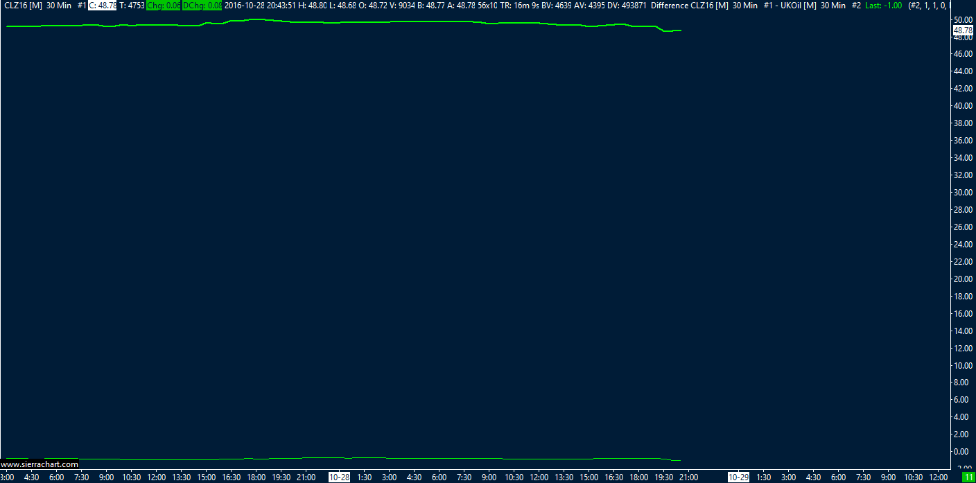

[2016-10-28 18:44:34]
User514370 - Posts: 62
Ok, see the result.
Thank you.
imageCLZ16 [M] 30 Min #1 2016-10-28 20_43_57.119.png / V - Attached On 2016-10-28 18:44:19 UTC - Size: 21.28 KB - 568 views
[2016-10-28 18:50:05]
Why are you still using the Difference study if that is not what you want to use? Remove it from the chart.
[2016-10-28 18:52:28]
Ok, but how may I get two symbol into one chart region? You recommend only Difference study for this purpose.. Two symbols in one chart | Post: 102408
[2016-10-28 19:03:19]
Go back to using the Overlay(Single Line) study as you were previously using. This is what we were inferring in posts #4 and #6.
