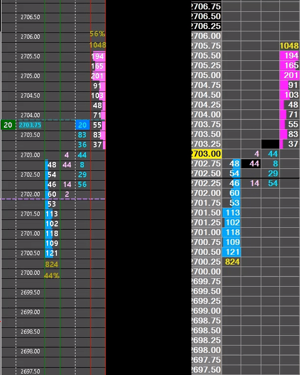

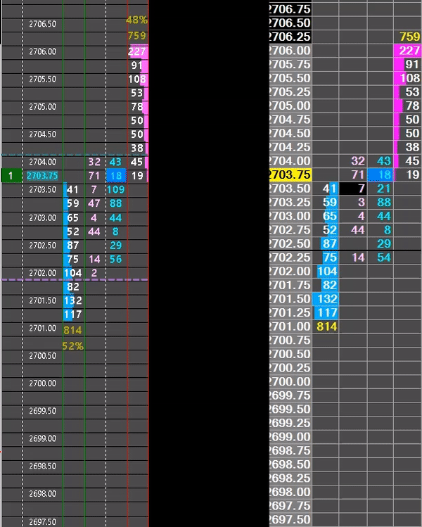

[2019-04-20 17:14:19]
whats1thingnow - Posts: 418
just tested, still the same problem as post #48.
please see attached gif (https://www.sierrachart.com/Download.php?Folder=SupportBoard&download=27758 )
it's 10x easier to see the problem on the video file - let me know if you want it
the key point is:
at 9 seconds of the gif, current best bid/ask is still at 2703.75 bid and 2704.00 ask, where 1 lot lifts against 2704.00
sc1895 recent bid/ask columns (sc1895 bug resets):
2704.00 4x1
2703.75 0x20
jigsaw recent bid/ask columns (DOES NOT RESET):
2704.00 4x118
2703.75 53x20
as seen in the gif, even though 2.5s elapsed, the recent bid/ask columns DO NOT RESET because the current best bid/ask left and FLASHED BACK to 2703.75 bid and 2704.00 ask.
thanks for the help!
imagesc1908_both_short.gif / V - Attached On 2019-04-20 17:12:54 UTC - Size: 1.72 MB - 3902 views

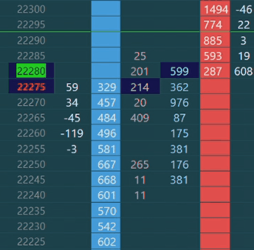

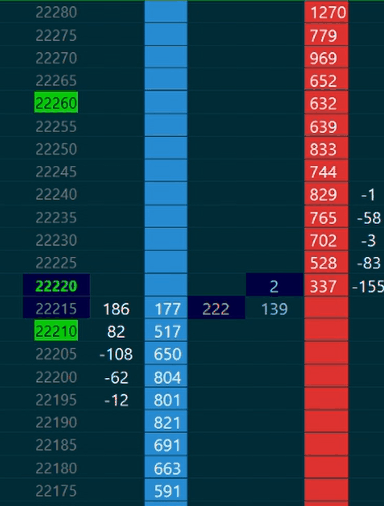

[2019-04-22 04:17:03]
User745789 - Posts: 402
Fix from 1906: "unexpected reset of the Recent Bid Volume and Ask Volume for a price level"
https://www.sierrachart.com/index.php?page=doc/Whats_New.php
I think I am still seeing it in 1908. I do not expect you to resolve from a gif, but I offer one as evidence.
Market was 15/20, nothing trading for a while. Recent B/O volume of 222 and 2 just vanishes.
Date Time Of Last Edit: 2019-04-22 04:19:21
image123.gif / V - Attached On 2019-04-22 04:16:53 UTC - Size: 2.23 MB - 850 views
[2019-04-22 05:12:06]
User574234 - Posts: 15
great example of the bug
as long as the best bid/ask is at 15/20, the recent bid/ask volume SHOULD NOT get reset
this is spot on:
the reset timer of 2.5 seconds should only start when another price becomes the best bid/ask, NOT WHEN price stays at the same best bid/ask

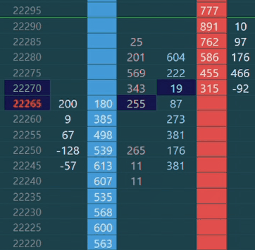

[2019-04-25 06:36:57]
Hello SC Eng, I have v1910 and it is now not happening very often at all compared to 1908. Now maybe only twice in 3 hours that I saw today. But it is still happening. See vanish.gif
Also, perhaps related, see offer.gif. Mkt at 75/80, 80s paid. Then 75s given. Mkt remains 75/80, yet the "last offer" background highlight moves to the 75 price level and recent volume at offer changes to 109 at the same time as recent volume at big changes. Why did the recent offer volume change to 109?
Both F.US.MJNKM19 and within a few minutes of each other.
Date Time Of Last Edit: 2019-04-25 06:37:26
imageoffer.gif / V - Attached On 2019-04-25 06:37:10 UTC - Size: 2 MB - 801 views
imagevanish.gif / V - Attached On 2019-04-25 06:37:23 UTC - Size: 2.14 MB - 989 views

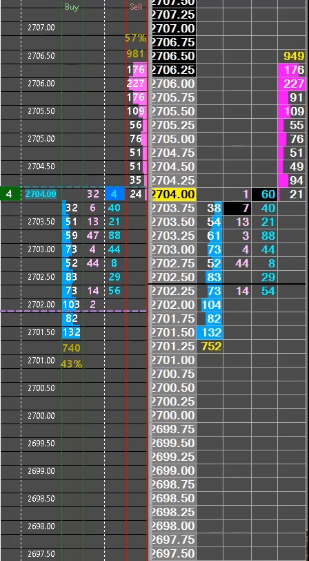

[2019-04-27 17:50:27]
tested 1912
WOW
WOW!
WOW!!!
do i dare say it?
yes... you guys fixed it!!!
see attached - the random vanishing is gone :)
the p1 gif (https://www.sierrachart.com/Download.php?Folder=SupportBoard&download=27930 ) shows one price didn't get reset when it did in jigsaw ...
but overall, it's 99%! it's GREATTTTTTTTTTTTTTTTTTTT enough
thanks for the hard work!
imagesc1912_both_short_p1.gif / V - Attached On 2019-04-27 17:48:38 UTC - Size: 2.1 MB - 2464 views
imagesc1912_both_short_p2.gif / V - Attached On 2019-04-27 17:48:45 UTC - Size: 2.75 MB - 2264 views
