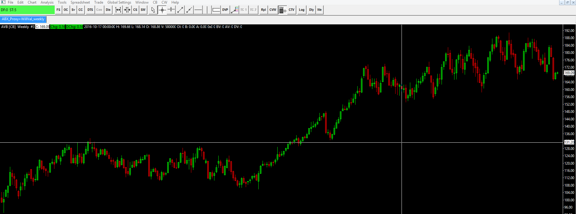

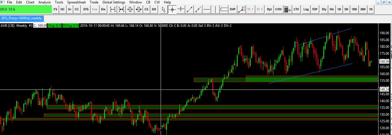

I've recently purchased SCH subscription. Prior to that I was testing my trading system on free demo stock datafeed.
By accident I've deleated and reloaded all data using now paid service and to my surprise the old and new did NOT match (see attached screenshots).
How can this be? All chart settings are the same. The new reloaded data corresponds with information given by finance.yahoo and thus the original data from demo datafeed were incorrect.
This is a big issue as it could completely change the outcome of the strategies I've been testing.
How could this happen? And how do I know it won't happent in the future?
Please advise.
imageNEW (paid).png / V - Attached On 2016-10-18 20:04:49 UTC - Size: 31.93 KB - 365 views
imageOLD (demo).png / V - Attached On 2016-10-18 20:04:53 UTC - Size: 37.03 KB - 437 views

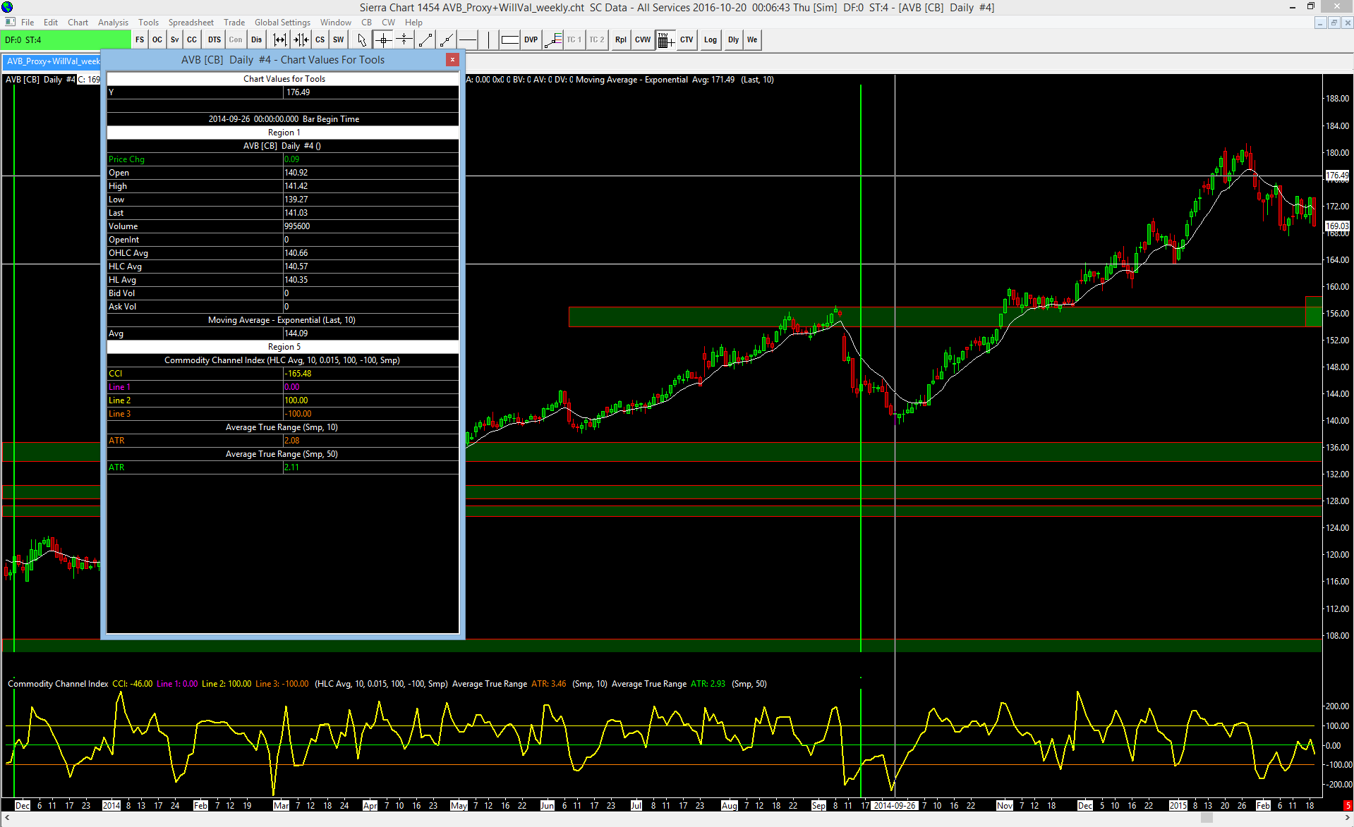

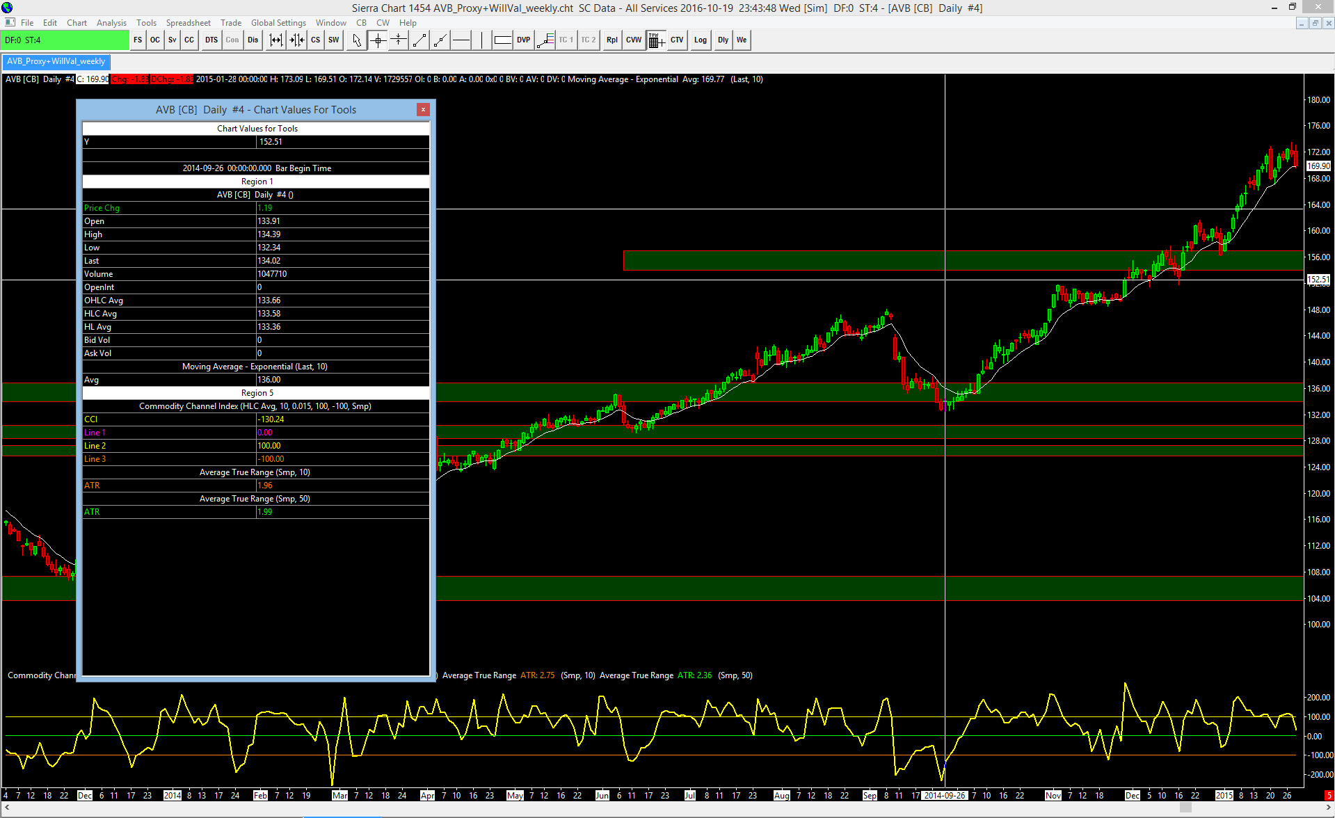

Okay, here it is in detail. As you can see the price on the same day doesn't match by 7 points on Close.
Again, the setting are exactly the same (NEW one was created by deleting AVB.dly from Data folder, opening the exact same chartbook and letting it automatically download the data over from my current paid SCH datafeed).
Prior data was from SCH demo datafeed.
The NEW prices are confirmed to be right by both Yahoo Finance and ThinkOrSwim data.
imageAVB_OLD.png / V - Attached On 2016-10-19 22:10:32 UTC - Size: 100.28 KB - 347 views
imageAVB_NEW.png / V - Attached On 2016-10-19 22:10:45 UTC - Size: 107.05 KB - 396 views
[2016-10-19 22:27:19]
When you say "demo vs. paid stock data". There is no such thing. The data is the same.
Although you say this:
The old chart is dividend adjusted data from another data source. We can tell that now clearly. This is what the evidence shows. Unless our data provider was providing different data previously, but we have never known that to be the case. And the the server should never deliver dividend adjusted data unless you specify that option.
