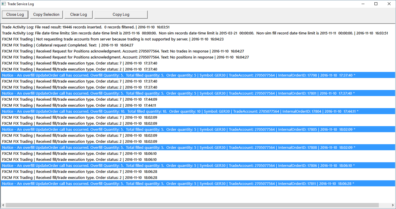

[2016-11-10 08:19:11]
Rainer - Posts: 112
I have the same 'overfill' issue with FXCM (see attached) ... so what would cause this, now that this is occurring with 'two' separate brokers?

imageSC1.png / V - Attached On 2016-11-10 08:20:11 UTC - Size: 523.64 KB - 435 views
[2016-11-10 09:05:37]
We have looked into this and implemented a patch for it. Follow the instructions here to update to the latest prerelease:
https://www.sierrachart.com/index.php?page=doc/download.php#FastUpdate
Sierra Chart does safely handle the overfill without any consequence.
Let us know if the problem is resolved after the update.
[2016-11-10 09:18:51]
Rainer - Posts: 112
That patch did fix it, (no more 'overfill' pop-up messages). Thank You for your prompt attendance!
