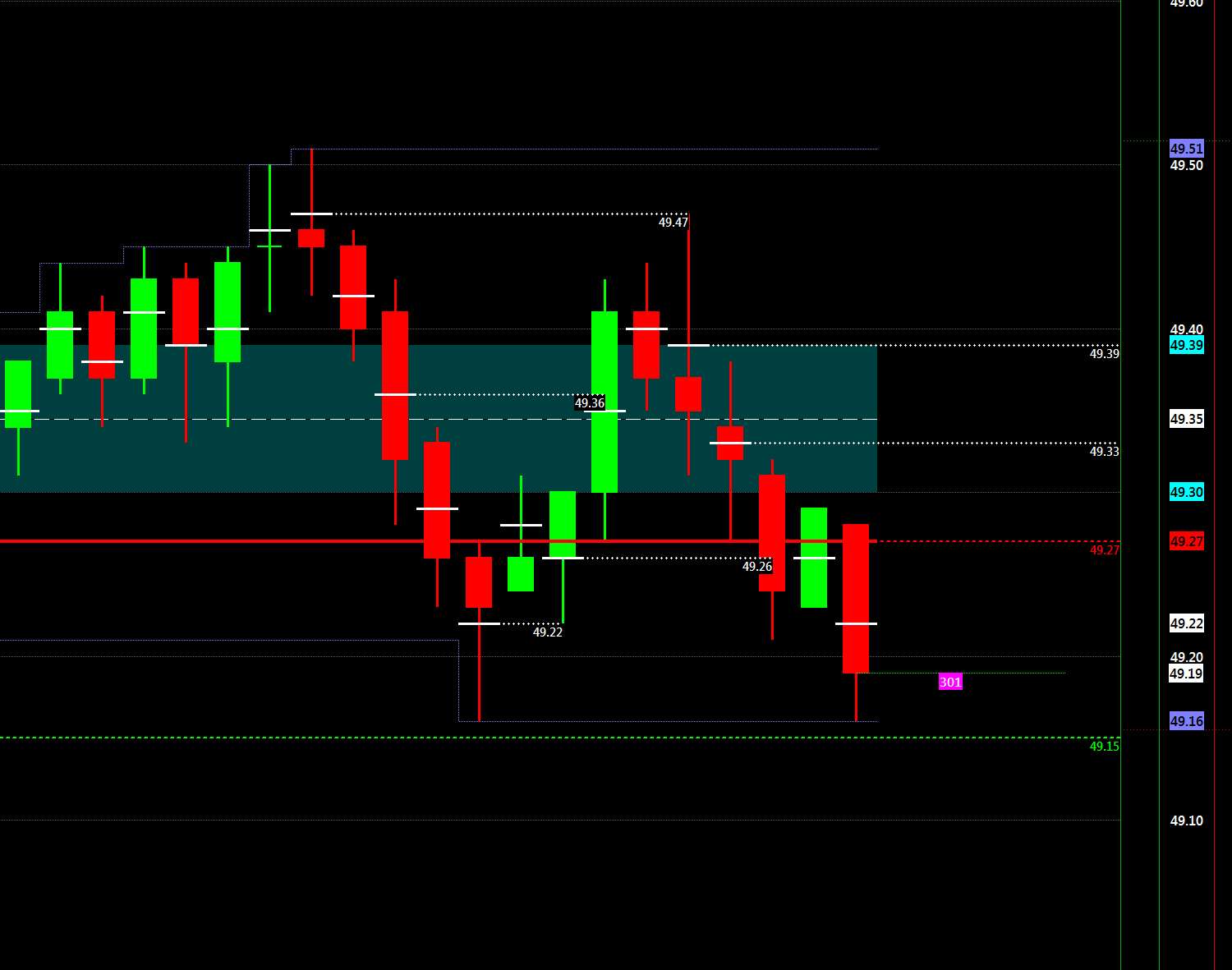

Remaining issue — name label position for always-extending lines
For lines drawn with:
LineStruct.EndBarIndex = 0;
LineStruct.AlwaysExtendToEndOfChart = 1; // active/extending line
the name label renders on/over the right-side value (price) scale, rather than in the right-side free space of the chart. For lines stopped at a specific EndBarIndex (AlwaysExtendToEndOfChart = 0), the name label renders correctly at that bar in chart space.
Looking at the s_LineUntilFutureIntersection struct, I don't see any member controlling the label's position, alignment, or anchor — only DrawNameLabel (on/off) and NameLabel (the text). The label appears to auto-anchor to the line's right terminus, which for an always-extending line falls at the far-right edge over the value scale.

What you are seeing is how the ExtendLinesUntilFutureIntersection functions work.
There are no controls over the positioning of the labels.
And there is no control for the z-order of those lines separate from the study that draws them.
