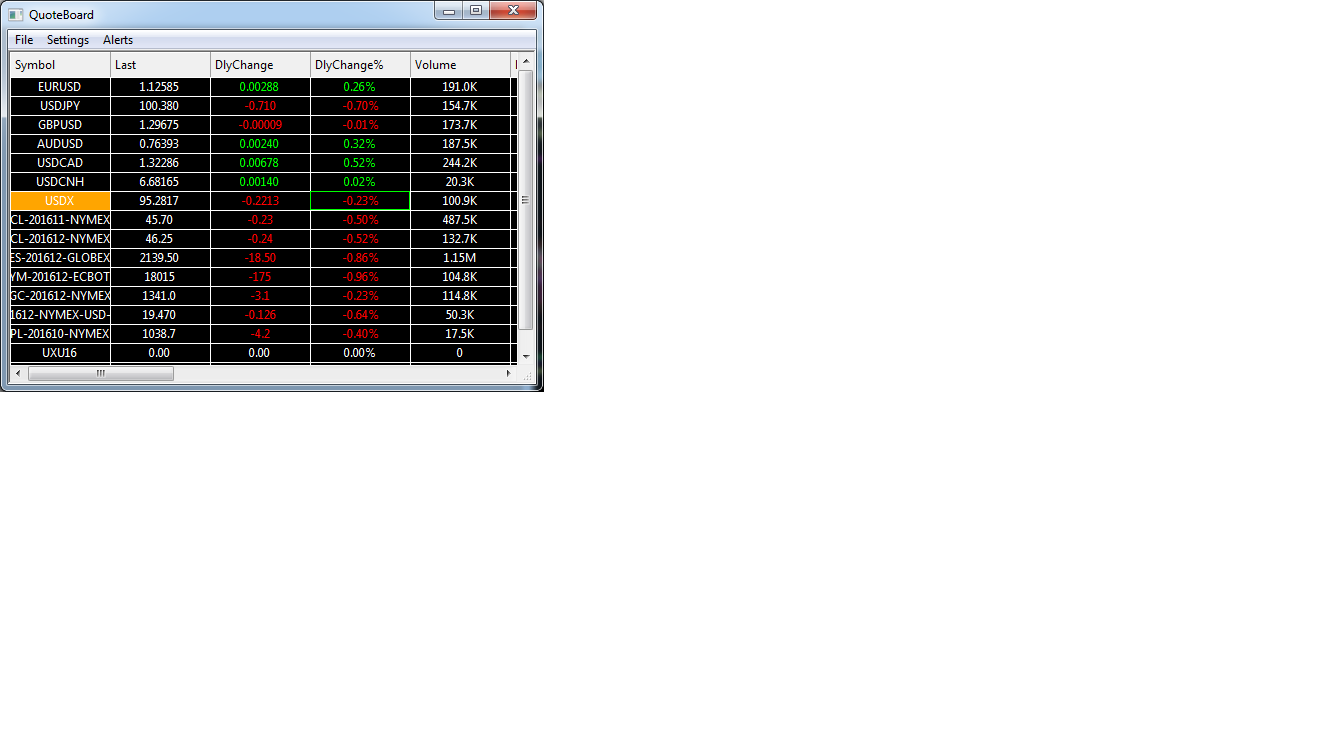

hi, i just notice my quoteboard's DlyChange% for CL change from ~+2.7% to -0.5% as per screenshot with the former being correct. the day has not ended yet but the platform seems to think it did? is that normal?
just fyi i have my time zone set to New York EST.
thanks.

Yes this does make sense. The CME has sent out a settlement price of 45.93 for today that the daily price change is calculated from:
http://www.cmegroup.com/trading/energy/crude-oil/light-sweet-crude_quotes_settlements_futures.html#tradeDate=09/26/2016
This is preliminary in the exchange could make some changes, but what you are seeing is all technically correct.

hi, shouldnt the daily change be against the t-1 close? unless i understand it wrongly and its a different terminology for CL futures? even on bloomberg it shows +2.7%. if the quoteboard shows it the way you say it is, then is there a way i can edit it to show the day change according to my definition?
thanks.

To see it that way you should look at a Historical Chart for that symbol and refer to the Net Change field.
There is no way to change this on a Quote Board.
