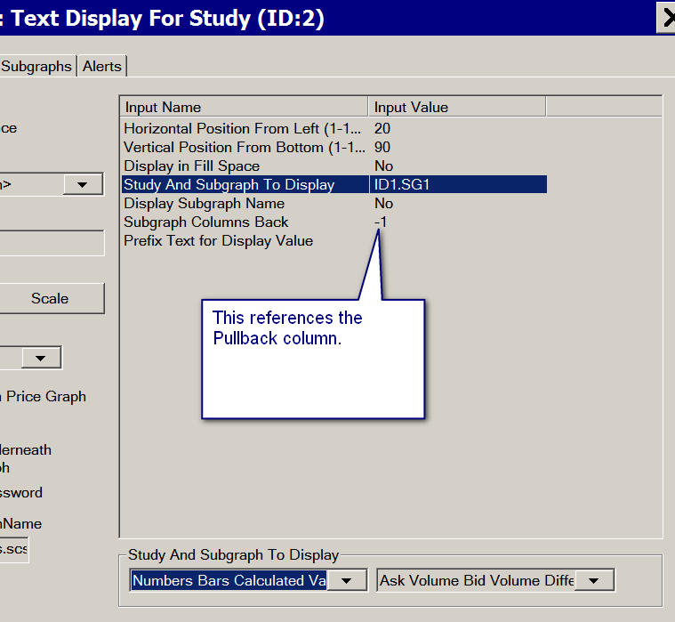

Verified that it does work.
See attachment for the Text Display for Study study.
