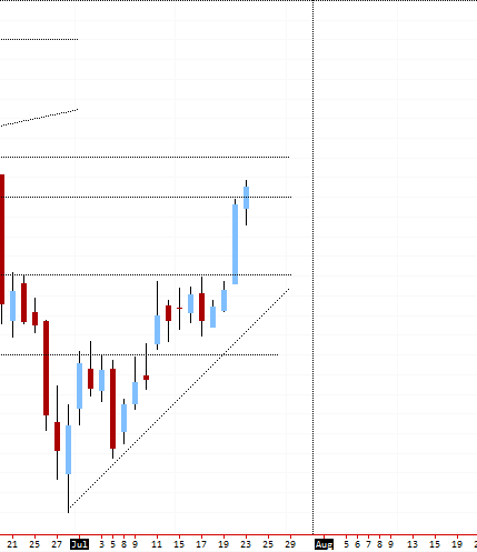

I am currently running version 997 and I use IQ Feed.
I generally look at my charts approx between 5-6pm NYC which is 7-8am Brisbane.
I have 2 charts which I will post below which shows QGC# historical daily chart.
Both screen shots were taken approx 610pm NYC Tuesday Evening/ 810am Brisbane Wednesday Morning
So first screen shot shows NYC time zone -
As you can see, a new bar hasnt been started for the evening session, but it has continued live pricing on the old bar.

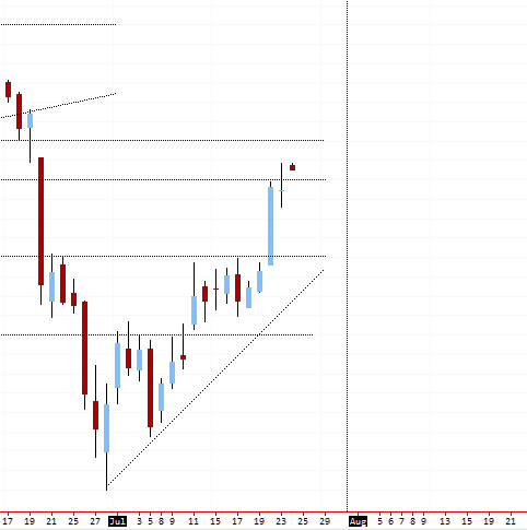

If you look at the second screen shot, which is Brisbane time zone, you can see that a new bar has been correctly created for the evening session (NYC Time that is) and it also shows the correct settle price for the previous days bar.
The problem I get with using local time (Brisbane) is that on some symbols I get a double up of bars. For the current day I get 2 bars instead of one on some symbols and it drives me crazy. Symbols such as @TFS# @DX# QCL# QRB# QHO# etc etc
And the problem as mentioned above using NYC is that I am not getting a new bar for the new session.
