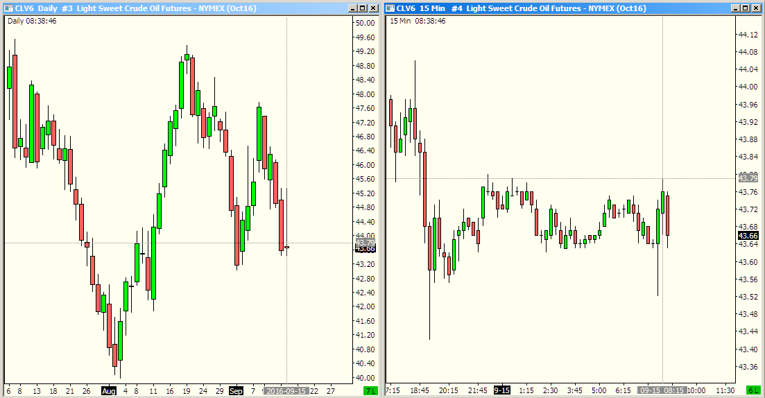

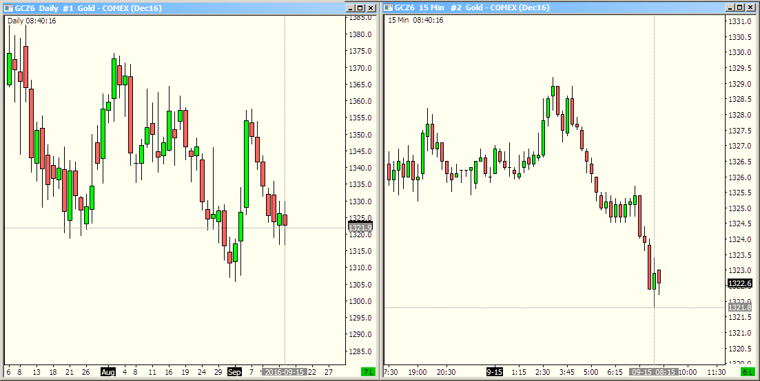

On the Daily Historical Chart, the High / Low of a last bar is the same as the High / Low of a previous bar. See attached pics.
The Delete and Downlaad Data do not help.
This issue occurs for several days except Monday.
The Time Zone is set to London (+0 GMT/+1 BST).
imageDaily GC.png / V - Attached On 2016-09-15 08:07:31 UTC - Size: 49.83 KB - 332 views
imageDaily CL.png / V - Attached On 2016-09-15 08:07:40 UTC - Size: 54.52 KB - 390 views

We think the primary reason for this problem is TransAct is not resetting the daily values soon enough. Or maybe not at all.
Follow through the instructions here:
http://www.sierrachart.com/index.php?page=doc/helpdetails12.html#h12.12
Date Time Of Last Edit: 2016-09-15 19:07:17

Marek F - Posts: 254
This issue does not occur if i close the Sierra Chart (File --> Exit) during or after a break in trading these contracts.
I do not close the SC because of a loss my drawings that are drawn by the Time and Sales data.
[2016-09-16 16:57:47]
Yes that would make sense but all you have to do is reconnect to the data feed as the documentation explains.
