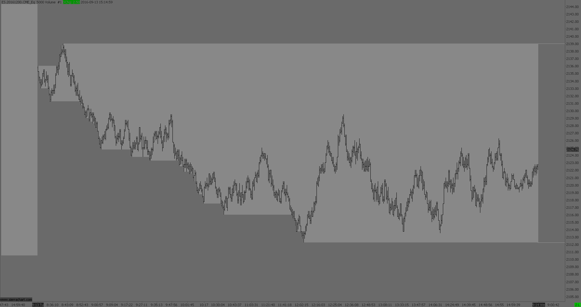

On the attached chart you can see a 5000 vol bar chart of the ES with the "Daily OHLC-Indicator". This indicator is set to: (a) graph high and low historically, (b) the HIGH to draw style "Trans. Fill Rect Top", (c) the LOW to draw style "Trans. Fill Rect Bottom" -> the result is a nicely colored area between the developing High and Low of the day, but that coloring of course stops where the locked right side fill space begins.
My question now is: How can I forward project the last coloring of the Daily OHLC indicator so that the same area is also colored in the right side fill space. I tried to use a second Daily OHLC-indicator with the setting "Line at Last Bar to Edge", but that only gives me two lines and does not color the area between those two lines. How can I color the area between these two lines??
http://www.sierrachart.com/image.php?Image=1473837772724.png

The study does not support this. You can modify it to meet your requirements:
http://www.sierrachart.com/index.php?page=doc/BuildCustomStudiesDLL.html
You will need to use this ACSIL Subgraph member:
http://www.sierrachart.com/index.php?page=doc/ACSIL_Members_scSubgraph.html#scExtendedArrayElementsToGraph
We cannot help further with this.
