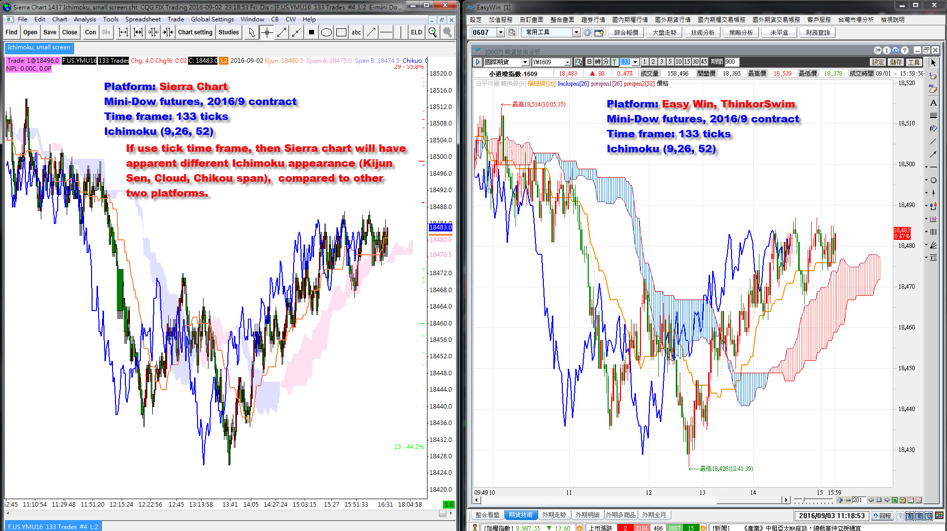

Hi Sir,
I observe that there are quite different appearances on Ichimoku charts (in ticks time frame) between SierraChart platform and other platforms.
Please refer to the attached figures.
The Ichimoku Charts will be the SAME among SierraChart and other platforms in normal time frames (such as 1 minute, 5 minutes, 1 hour, daily, etc).
However, if time frame is switched to tick (such as 133 ticks, 533 ticks), then Ichimoku charts will looks quite different between SierraChart platform and other platforms.
Please advise how to resolve the problems in Sierrachart?
Thank you
CHI CHIN YEH
imageIchimoku chart difference between Sierra chart and othe plat.jpg / V - Attached On 2016-09-03 03:54:36 UTC - Size: 719.34 KB - 538 views

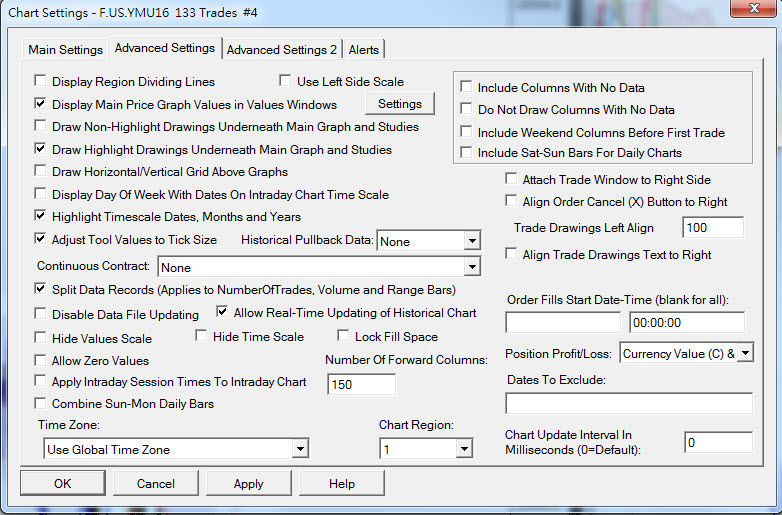

imagechart setting, main setting.jpg / V - Attached On 2016-09-03 04:03:28 UTC - Size: 175.37 KB - 435 views

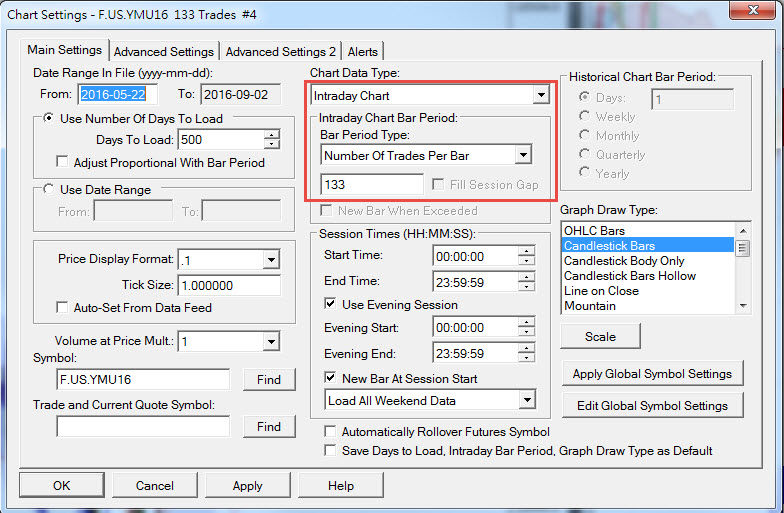

imagechart setting, advanced setting.jpg / V - Attached On 2016-09-03 04:03:44 UTC - Size: 194.51 KB - 463 views
[2016-09-03 09:07:07]
The Ichimoku calculations are simple.
If you do not notice a difference with fixed time bars, then the only explanation is that there is a difference with the number of bars or the bar Open, High, Low, Close values between the charts.
So you have to look at the bars themselves and see where the differences are with the bars.
If you notice bar differences, then refer to:
Number Of Trades, Volume or Range Bar Charts Do Not Match Setting or Are Not Accurate or Are Inconsistent
