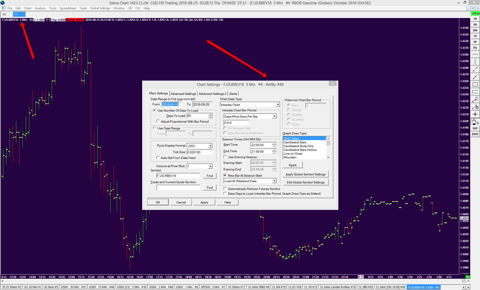

I'm trying to open a 4hour chart however each time I go to a 4hour chart it converts back immediately to a 5min chart. I think it has something to do with RefBy: #49 in the title bar in Chart Settings [F5]. Please see attached..
I have tried to duplicate chart but still does not work. Please can you help.
Rgds, Mark
imageSC_5min_error.png / V - Attached On 2016-08-25 02:32:45 UTC - Size: 128.36 KB - 430 views
[2016-08-25 05:43:15]
Refer to:
http://www.sierrachart.com/index.php?page=doc/helpdetails18.html
You do need to remove the reference to it from chart number #49. You can see that chart listed on the CW menu.

..please see attached. I have tried to duplicate this chart to get a 'fresh' chart but still has the same ref. It refers to my main trading chart.

Do this:
1. Select File >> Save.
2. Go to chart #49.
3. Remove one study at a time from this chart
4. Go back to the chart that you are trying to change the bar time period of. If you can do it, then the removed study is the problem.
Repeat steps number 2-4.
5. Once you determine what study is causing the problem, then close the Chartbook without saving it.
6. Reopen the Chartbook to restore it as it previously was.
7. You can then remove the study which is causing a problem on chart 49.
[2016-08-31 13:01:21]
User78926 - Posts: 69
ok seemed to have sorted prob by deleting all the (hidden) studies, just not sure if that was per chance or the actually the problem. But thx anyway for your help :-)

..it looks like it was an Overlay [Single line]
[2016-08-31 20:46:08]
OK not sure why there would have been a problem then because that study would have had its Chart Number input automatically set to zero when you pressed yes to remove the references.
