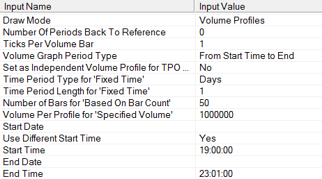

Unfortunatelly, it didn´t help.
Please, see attached print screens with my settings.
Thank you!

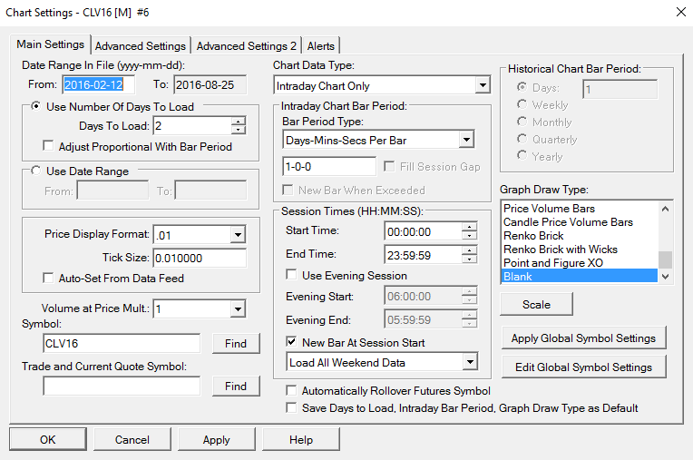

Thank you, but it didn´t help. Please, check out attached image with my Sesstion Times settings.
imagechart_set.PNG / V - Attached On 2016-08-25 06:39:31 UTC - Size: 39.03 KB - 456 views
[2016-08-25 07:36:07]
We see what the problem is. Set the Chart >> Chart Settings Days-Minutes-Seconds setting to 0-1-0
