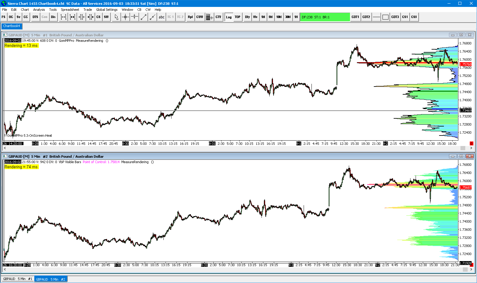

You can also use the high performance GomMPPro study (it's commercial), it was very heavily optimized for drawing speed and is much faster then the VbP study.
It is specially efficient on instruments with a low tick size.
Please have a look at the following screen cap, VbP rendering 70ms, GomMP 15ms.
You can check if for free for 20 days on www.gomicators.com
imagegommpperformance.png / V - Attached On 2016-09-03 16:39:59 UTC - Size: 69.19 KB - 393 views
