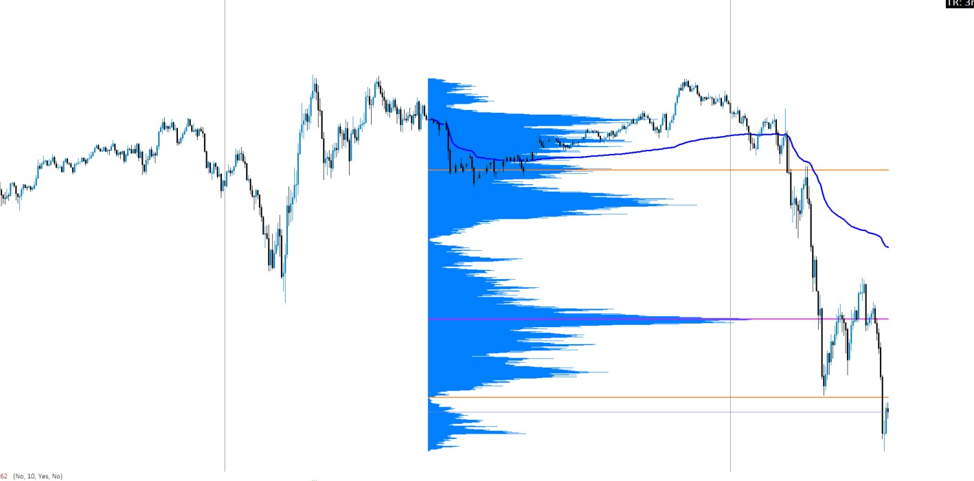

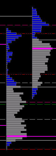

I have read the documentation quite a bit, and I can't find how to have the Value Area one color and outside the Value Area another color? (Please see attachment).
imageVolume by Price.png / V - Attached On 2016-08-14 22:11:33 UTC - Size: 2.38 KB - 692 views

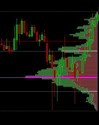

I have the fill color set to gray, but I'm still getting dark red as part of the bar. Can you tell me how to set the color to just gray?
Also, I can't figure out how to set the bar color, for the bars that are outside the Value Area to a different color?
One last thing... after making the changes you'll see on the attachment, I save it to be the default, and I added it to another chart, and it went back to the original settings.
Thanks,
Date Time Of Last Edit: 2016-08-15 01:08:27
imageVBP.png / V - Attached On 2016-08-15 01:07:10 UTC - Size: 4.98 KB - 560 views
[2016-08-15 01:05:17]
[2016-08-15 01:09:33]
User488039 - Posts: 114
Here is an image of the current setup.
Date Time Of Last Edit: 2016-08-15 02:19:22
imageVBP.png / V - Attached On 2016-08-15 02:19:08 UTC - Size: 4.98 KB - 621 views

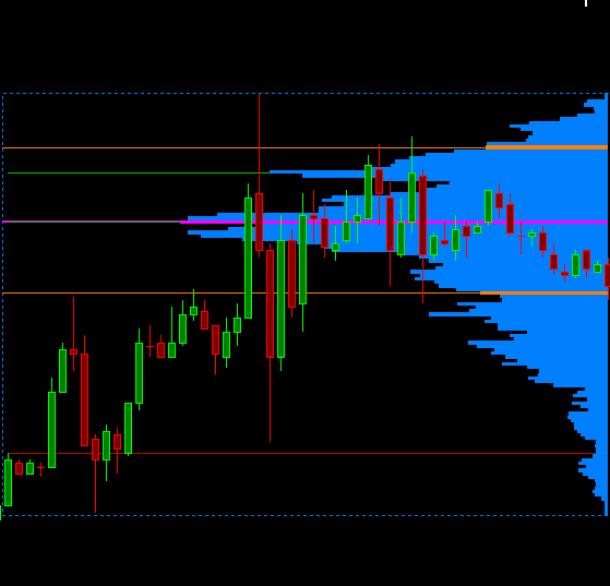

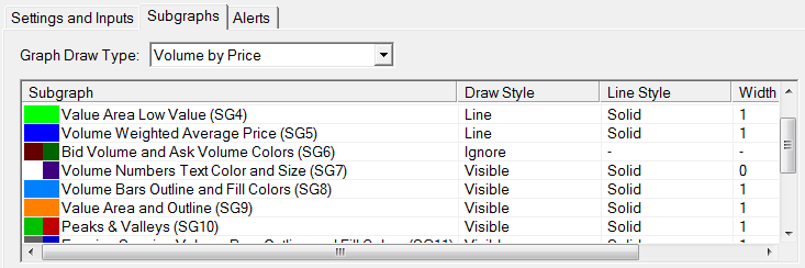

Thanks Acro, but this is what I get when set it that way. It does not make the bars outside the Value Area Orange, just the VAL lines.
imageParameters.png / V - Attached On 2016-08-15 16:45:25 UTC - Size: 17.61 KB - 622 views
imageVolume Profile.png / V - Attached On 2016-08-15 16:45:32 UTC - Size: 3.98 KB - 582 views
[2016-08-15 18:17:59]
Are you aware that you have set Highlight Value Area High and Low Only to Yes?
To do what you want you need to set both the primary and secondary colors for this Subgraph to orange:
https://www.sierrachart.com/index.php?page=doc/VolumeByPrice.php#VolumeBarsOutlineFillColorsSubgraph
[2016-08-15 20:52:18]
Thanks, this is what I've been looking for. I wish someone would have told me this yesterday.

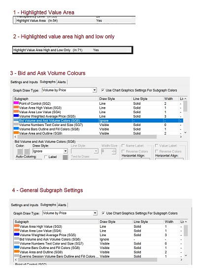

User561654 - Posts: 4
I too like this author am having a real difficult time finding how to have the Value Area one colour and outside the Value Area another colour
Here's what Ive done so far - please also see attached and numbered screenshots:
1 - I have 'Highlight Value Area' set to yes
2 - I have 'Highlight Value Area high and low only' set to yes
3 - In Subgraphs I think I have "Bid Volume and Ask Volume" colouring set to "None", or rather "Ignore"
4 - These are my general subgraph settings
5 - please see my attached end result
Are you able to further instruct me to know what I'm missing. Ive read the pages of documentation posted above, read and applied everything in this thread so any specific and direct instruction would be really helpful. Many Thanks
imageVolume Profile Settings.jpg / V - Attached On 2024-08-28 18:41:59 UTC - Size: 61.04 KB - 231 views
image5 - End Result.jpg / V - Attached On 2024-08-28 18:42:15 UTC - Size: 86.83 KB - 295 views
[2024-08-28 19:35:46]
Set the following Inputs as follows:
- Highlight Value Area High and Low Only: No
- Bid Volume and Ask Volume Coloring Method: None
[2024-08-28 21:53:01]
Yes that solved it. Was looking at Bid and Ask Volume in the Subgraphs section instead of Settings and Inputs. Thanks for getting back to me so quickly. Much appreciate it
