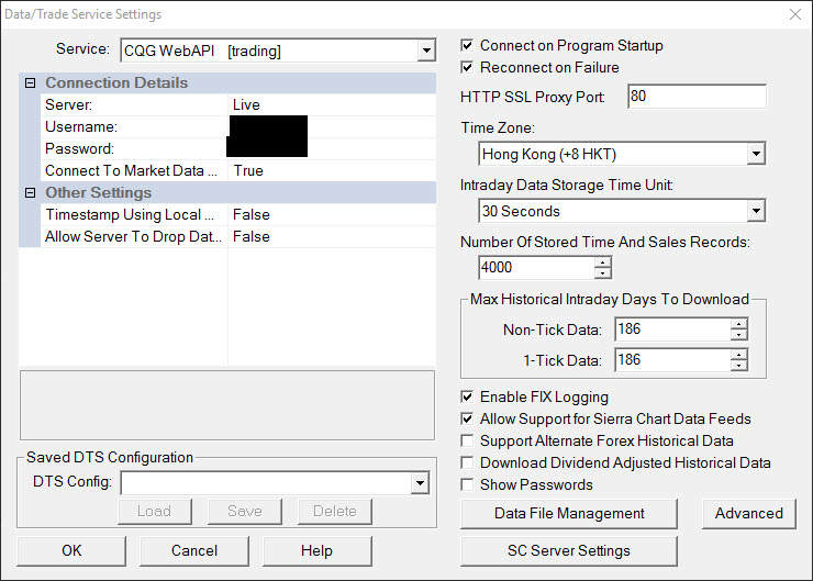

I have CQG historical data enabled however I am only getting real time data coming in and not historical data. When I originally logged on it was not enabled which I then rectified with my broker to have enabled. However the historical data is still not coming through.
Please see attached my settings to see if I have anything out of order?
Thank you.

[2016-08-04 05:33:33]
Tell us one of the complete and exact symbols you are not getting historical data for.
Provide a copy of the Message Log by following these instructions:
http://www.sierrachart.com/index.php?l=PostingInformation.php#MessageLog

[2016-08-04 06:05:45]
We do not see any obvious problems with the historical data for F.US.HSIQ16 . Go to that Intraday chart and select Edit >> Delete All Data and Download. That should solve the problem.
Also refer to:
Historical Intraday Data (Missing Data / Download Errors / Viewing More Data): Downloading/Viewing More Historical Intraday Data
Date Time Of Last Edit: 2016-08-04 06:06:34
[2016-08-04 07:53:11]
User513662 - Posts: 93
Thanks this reset worked.
