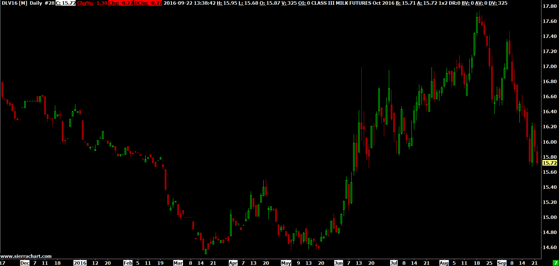

What we said is this:
If Sierra Chart does not provide rollover rules, then any rollover rules you have defined will remain the same.
Here is a historical chart of milk futures using the real-time data feed and it looks correct for us:
http://www.sierrachart.com/image.php?Image=1474565955452.png
This chart is being updated with real-time data. We do not see why there would be any problem at this point in time as long as the symbol settings are updated and you have reconnected to the data feed.
