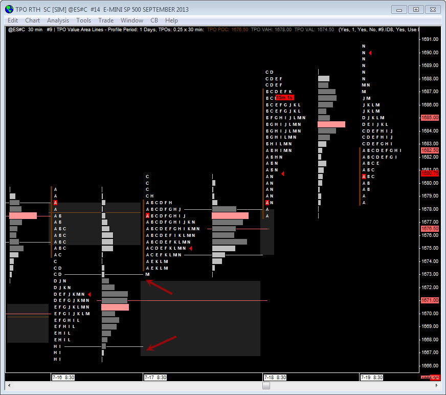

Can you confirm on your side with 30 minutes charts using the @ES#C IQFeed symbol?
I'm seeing some out of sync days when I overlay the TPO Value Areas from a 30 minutes bar chart into the TPO chart.
This should be in sync since we are dealing with 30 min periods.
imagees_outofsync.png / V - Attached On 2013-07-29 11:40:14 UTC - Size: 51.56 KB - 907 views

Still trying to understand what happened here.
I created a new chartbook and new charts so I could send to you but when I got all studies set up I noticed that the overlay was now in sync.
I went back to my chartbook and I could still see the overlay out of sync. I remembered to reload and recalculate all charts/studies. This ended up fixing the problem, I think, since from that moment all charts became perfectly in sync.
Question, when we have charts with one symbol and then change to a symbol which trades on a different exchange, on a different time zone, can this confuse some studies, namely the ones that depend on time to make their calculations?
I had all my charts set to ZN and than using the same charts I changed the symbol to ES and it seems that something went off while doing this that apparently was fixed by reload and recalculate the data.
