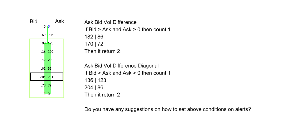

[2017-01-27 06:30:40]
User701247 - Posts: 117
Referring to attached image and given sample, I would like to know on how to define following variables as shown below:
//Bid Volume;Ask Volume;Total Volume;Number of Trades;Ask Volume Bid Volume Difference; Diagonal Ask Volume Bid Volume Difference;
int Ask_Bid_Vol_Different = Would following code comparing the Ask and Bid vol difference on same level?
if (ComparisonMethodIndex == 4)
int AskVolumeBidVolumeDifference = p_VolumeAtPrice->AskVolume - p_VolumeAtPrice->BidVolume;
int VolumeThresholdSigned = VolumeThreshold.GetInt();
if (AskVolumeBidVolumeDifference > 0 && VolumeThresholdSigned > 0 && AskVolumeBidVolumeDifference >= VolumeThresholdSigned)
ConditionMet = true;
else if (AskVolumeBidVolumeDifference < 0 && VolumeThresholdSigned < 0 && AskVolumeBidVolumeDifference <= VolumeThresholdSigned)
int Ask_Bid_Vol_Different_Diagonal = What about the coding comparing the Ask and Bid vol difference on Diagonal level?
if (ComparisonMethodIndex == 5)
Since the reference document is not available yet, do you have any suggestions on what variable should be used for retrieving AskVolume and BidVolume at Diagonal level?
int AskVolumeBidVolumeDifferenceDiagonal = p_VolumeAtPrice->? - p_VolumeAtPrice->?;
Furthermore, I would like to search for any variable's description, is there any search feature under sierrachart.com? so I can easily to read the description on any variables.

[2017-01-27 17:42:27]
This is a programming question and is outside the scope of our software.
At the top right of all webpages is a search box you can use to search for text in the documentation.
