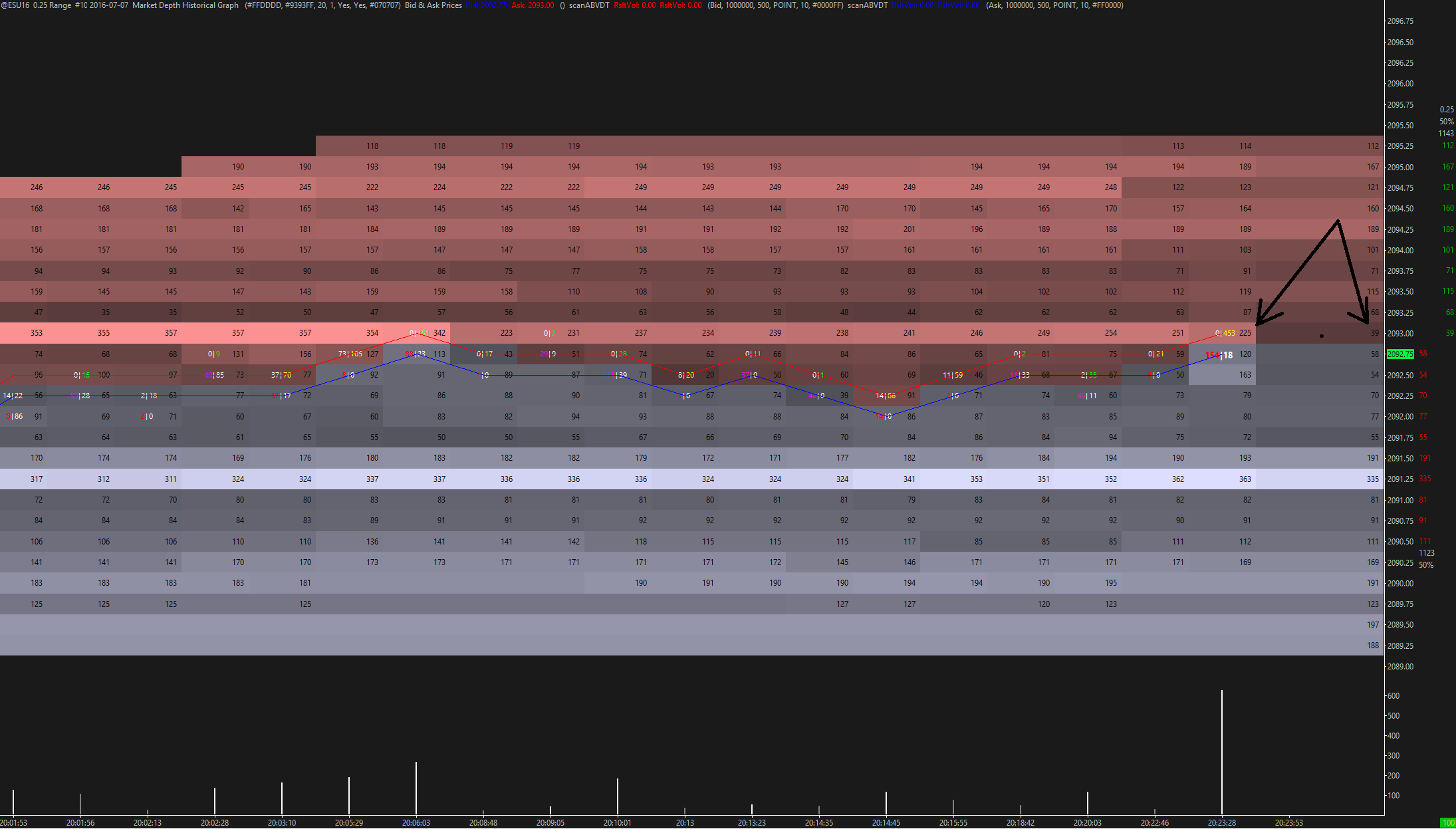

Could you please make a change so that range based charts will display depth with real-time updates, instead of updating based on bar close/ new range.

We do not understand this. The Market Depth Historical Graph study works identically no matter what the Bar Period Type is set to. It is not affected differently by Range bars.
We do not understand what you are trying to show in the chart image.

I'm showing that the current bar with a 20:23:28 timestamp, shows a 225 contract order when it should have changed in real time to show 39(so it reflects the current offer in the book).
That 225 was either calculated from the previous bar close, or from the open, so it remains static.

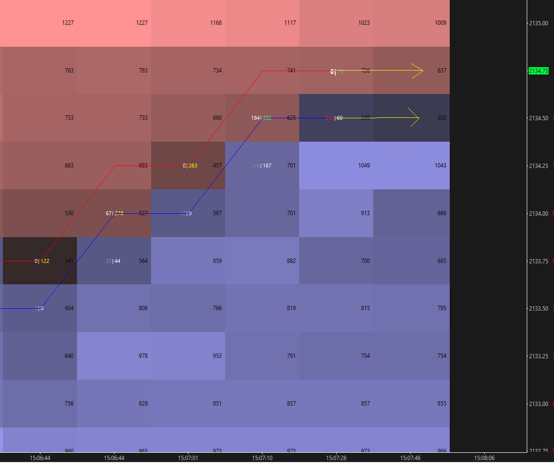

Thanks, I see you have added an input to show the depth value based on bar close- this is an improvement. An important measure from this study is how many contracts remained at a price level, without being executed. Sure there is no right or wrong, there's also alot of metrics to consider tracking eg (closing bid/ maximum bid), (closing ask/ maximum ask).
Re the Alignment.
See attachment- what I'm saying is that the bid/ask prices should be extended into the future. Also, Look at the numbers bar study that is loaded onto the chart, it is printing values on a static bid/ask( 348bid/ 726ask), when really those prints should appear against the real-time bid/ask, and not the bid/ask based on the close of the last bar. It's like trading in the past instead of the present. Does that make sense?
