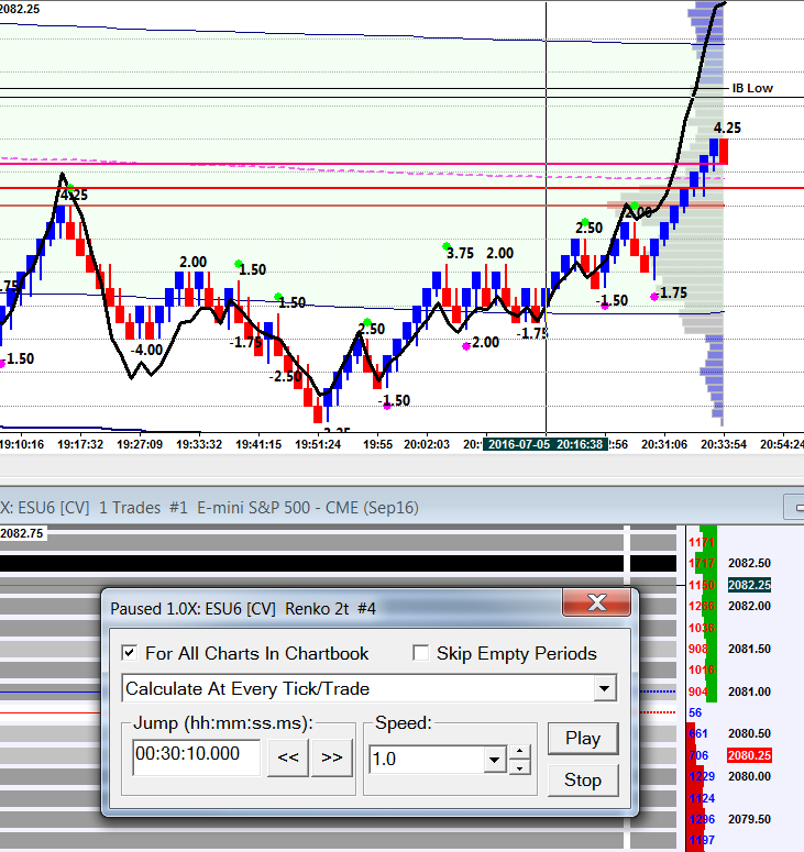

amirN - Posts: 171
Many times during replay the DOM levels are out of sync with the last price (even with a replay speed of 1).
For example in the attached file the last trade was at 82.5 while the bid and offer or at 81.75-82.00
Is there anyway I can bring them back in sync. The T&S agrees with the last price.
attachmententryimage.tif - Attached On 2016-07-05 20:54:04 UTC - Size: 236.79 KB - 738 views

We looked into this, and could not duplicate the issue using the Sierra Chart Exchange Data Feed which uses accurate time stamping from the server for trades and market depth data.
So we think the problem is going to be with differences of time stamping between the Intraday trade data and market depth data.

[2016-07-15 09:39:30]
We still were not told the particular global time zone setting you are using.
In any case, we saw the problem and there is no doubt it is due to time stamping differences with the market depth data from the service you are using.
Refer to:
https://www.sierrachart.com/index.php?page=doc/MarketDepthHistoricalGraph.php#MarketDepthDataTimeStampingAndReplays
It appears as though you are using OEC and we looked at how the time stamping is done and it is accurate. So we do not know how we can help with that further. We recommend you use the Sierra Chart Exchange Data Feed for accuracy with market depth data.
