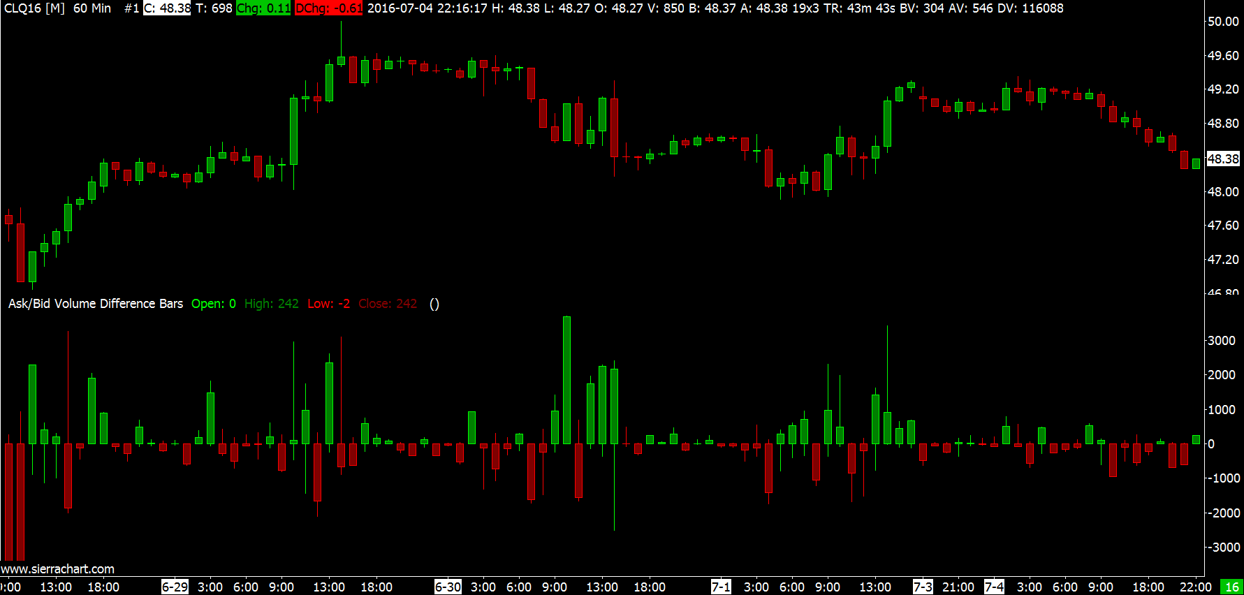

Hello, I´m little bit confused by what I´m sometimes getting from AskBid difference study. Please, see the attached image, yellow rectangle. AskVol is 45339, BidVol 43160, but price went down from open at 49,09 to 48,41. Price movement is in contrary to what´s happening on Ask/Bid. May I ask you about your idea about this? Thank you indeed!

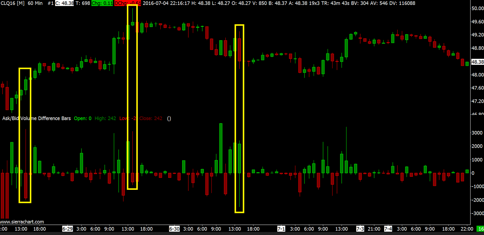

OK, I marked yellow boxes in your file.
Please, go through it and let me know.

We know the data is accurate. Whether it makes sense or not, is another question.

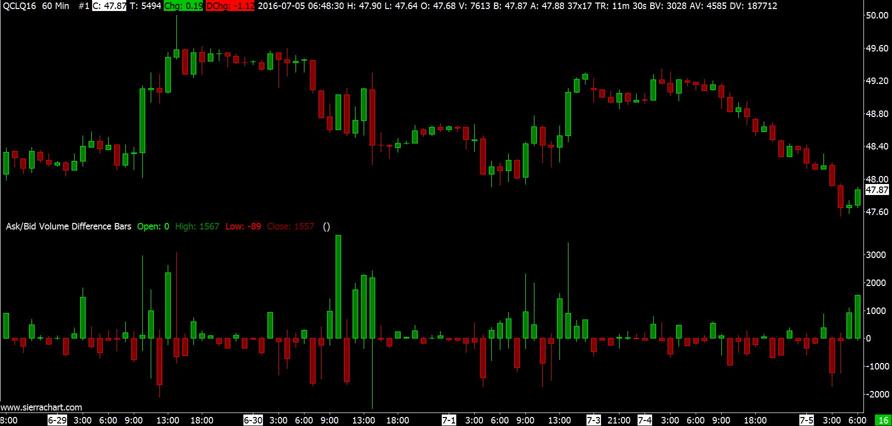

This is what we see when using IQ Feed:
http://www.sierrachart.com/image.php?Image=1467716319275.png
The SC Data Feed will be more accurate.
