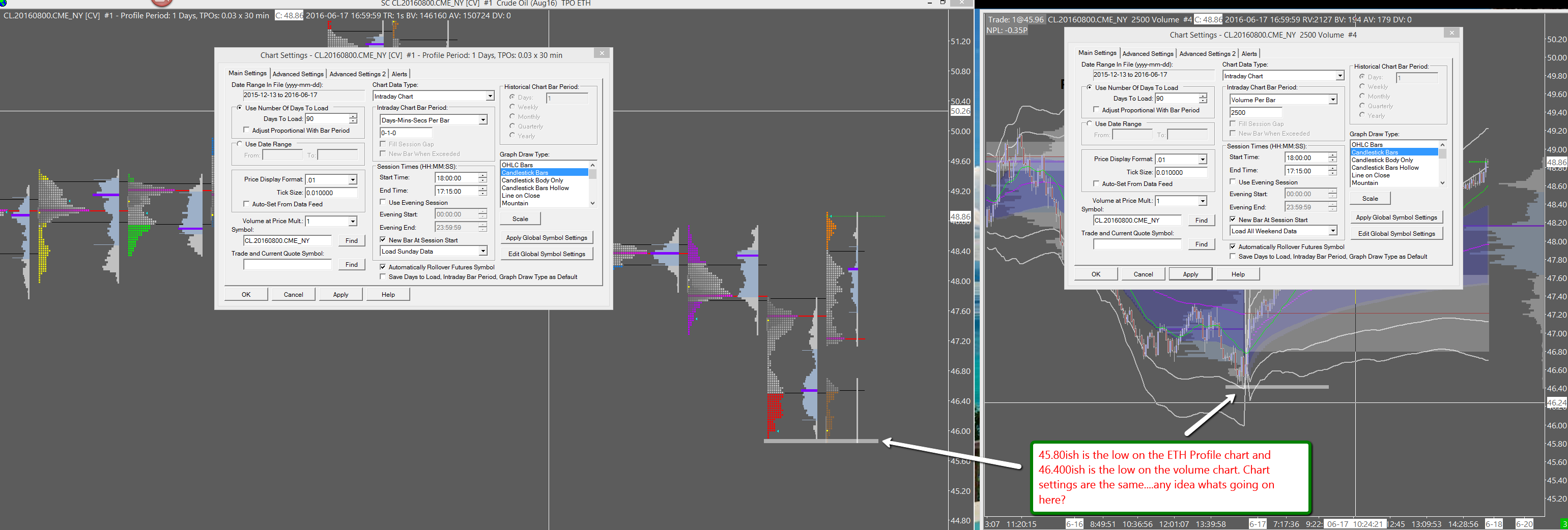

I have an ETH Profile chart with correct data. The symbol shows the [CV] (volume adjusted rollover) at the top which is correct. The remainder of my charts....see screen shot....is not showing this and consequently, has the wrong data. The profile chart is showing 45.92 as the low of Thursday last week. The volume chart is showing 46.43 as the low. I have about 10 other charts all open to this symbol and they all show 46.43 as the low. I confirmed the correct low with a friend.
How do I correct this issue?
Secondly, the profile chart has a gap in the data. Not sure how to address this.

There is no term "volume adjusted rollover".
There is Continuous Futures Contract-Volume Based Rollover.
You need to choose this same option for your Volume bars chart since you are using it for the TPO Profile chart. Here are instructions:
Continuous Futures Contract Charts: Using Continuous Futures Contract Charts
There is also this helpful documentation here:
https://www.sierrachart.com/index.php?page=doc/doc_ContinuousFuturesContractCharts.html#DisplayingRolloverDatesContractMonths

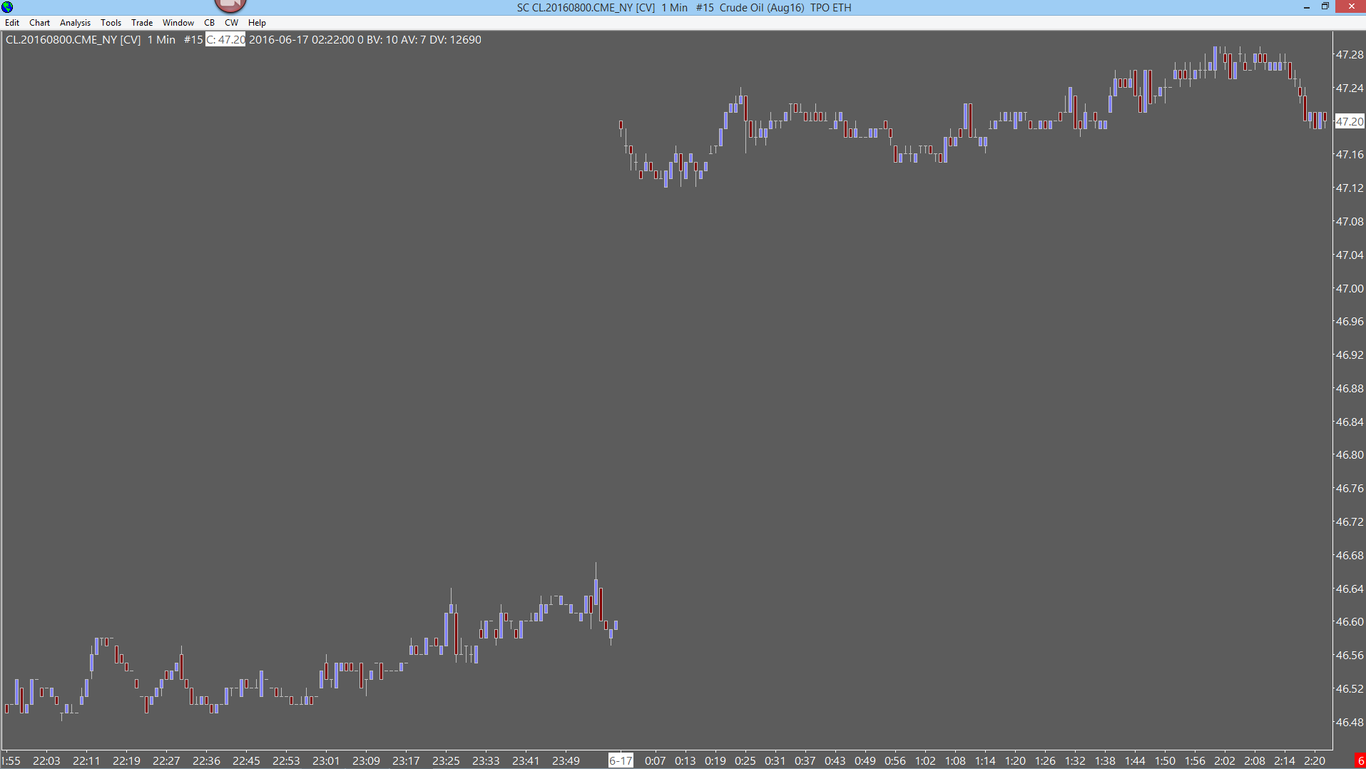

We need to get an image of the chart without the TPO Profile Chart study showing the missing data. Be sure to scroll the chart exactly where the missing data is.
[2016-06-20 02:02:46]
User718702 - Posts: 7
Here you go...
image2016-06-19_1901.png / V - Attached On 2016-06-20 02:02:23 UTC - Size: 42.2 KB - 380 views
[2016-06-20 02:06:58]
It is not possible for us to tell from this chart image whether there is actually missing data. What we see is a price gap.

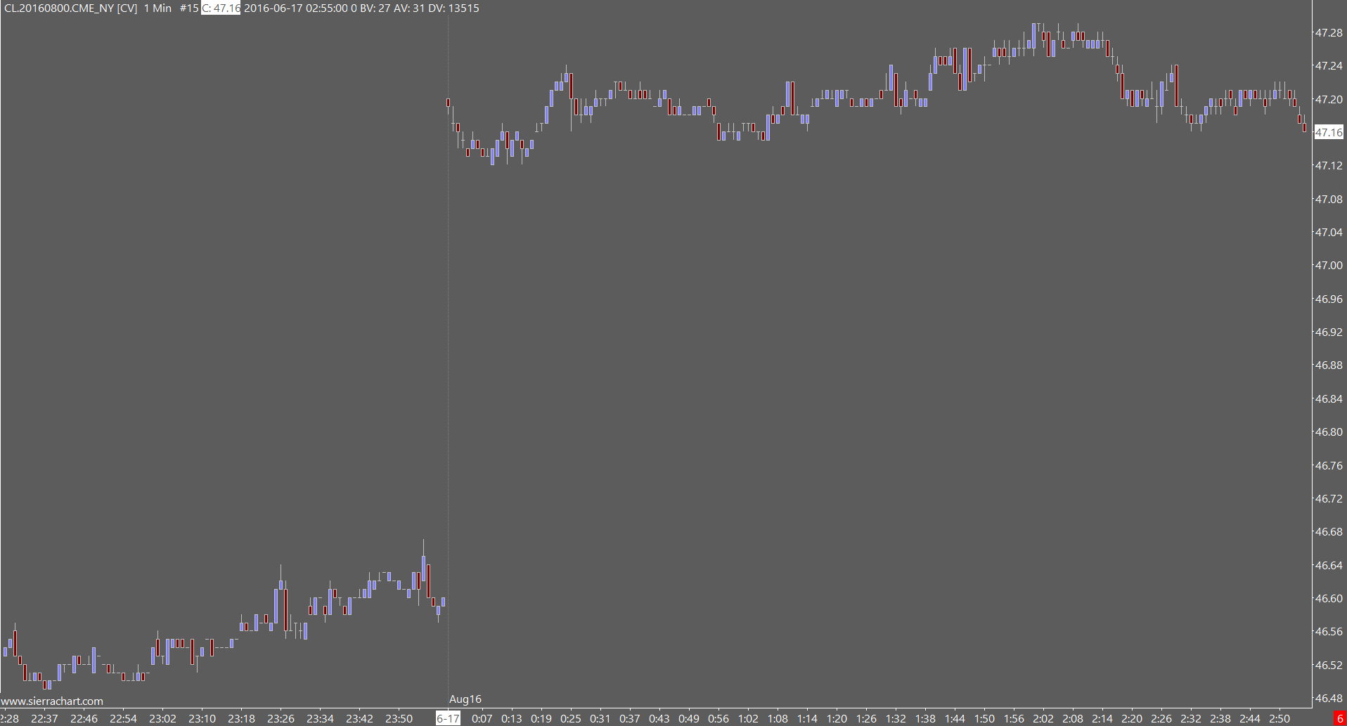

Enable Chart >>Show Rollover Dates and post an image again following these instructions:
[2016-06-20 02:19:18]
here is the chart via the chart upload function
http://www.sierrachart.com/image.php?Image=146638912817.png
[2016-06-20 02:23:24]
So the price gap is due to the transition from the July contract to the August contract.
This is the reason why you see what you do. It is possible to back adjust the data to eliminate the gap but that is not always what you would want to do.
