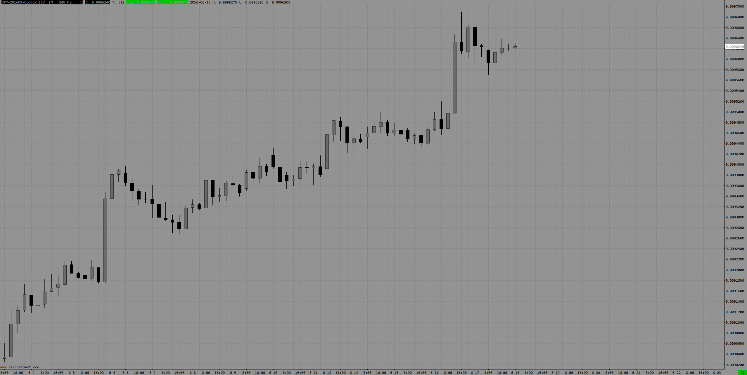

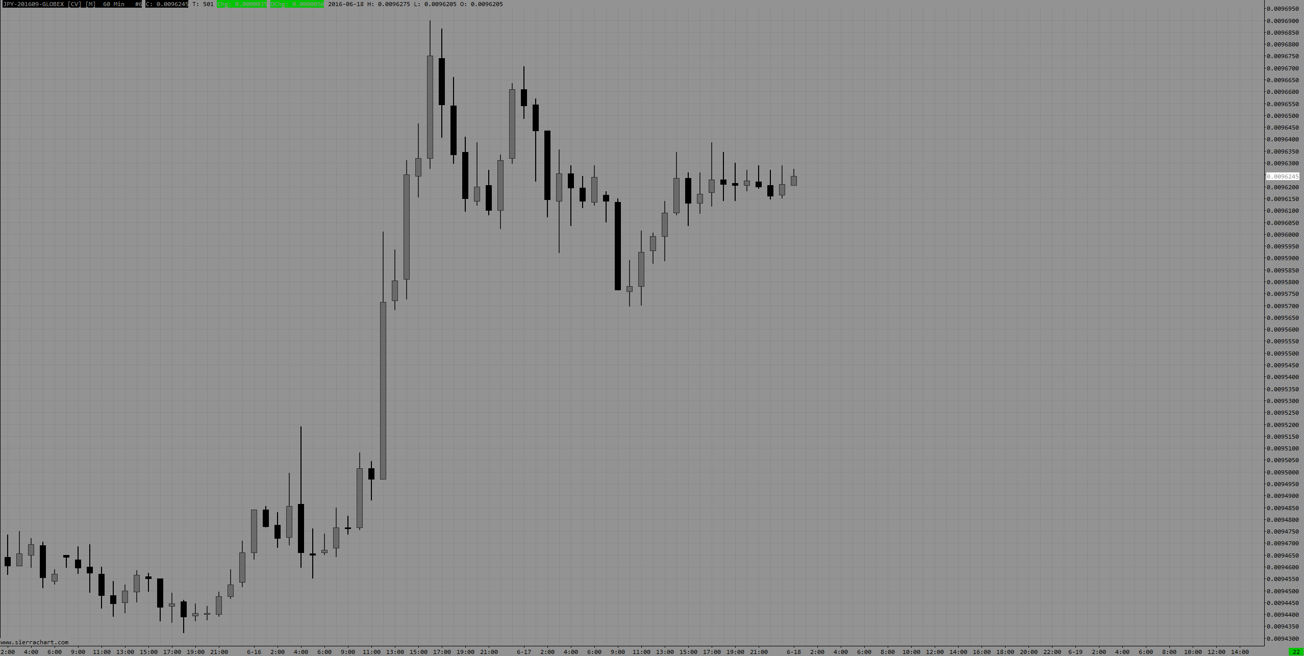

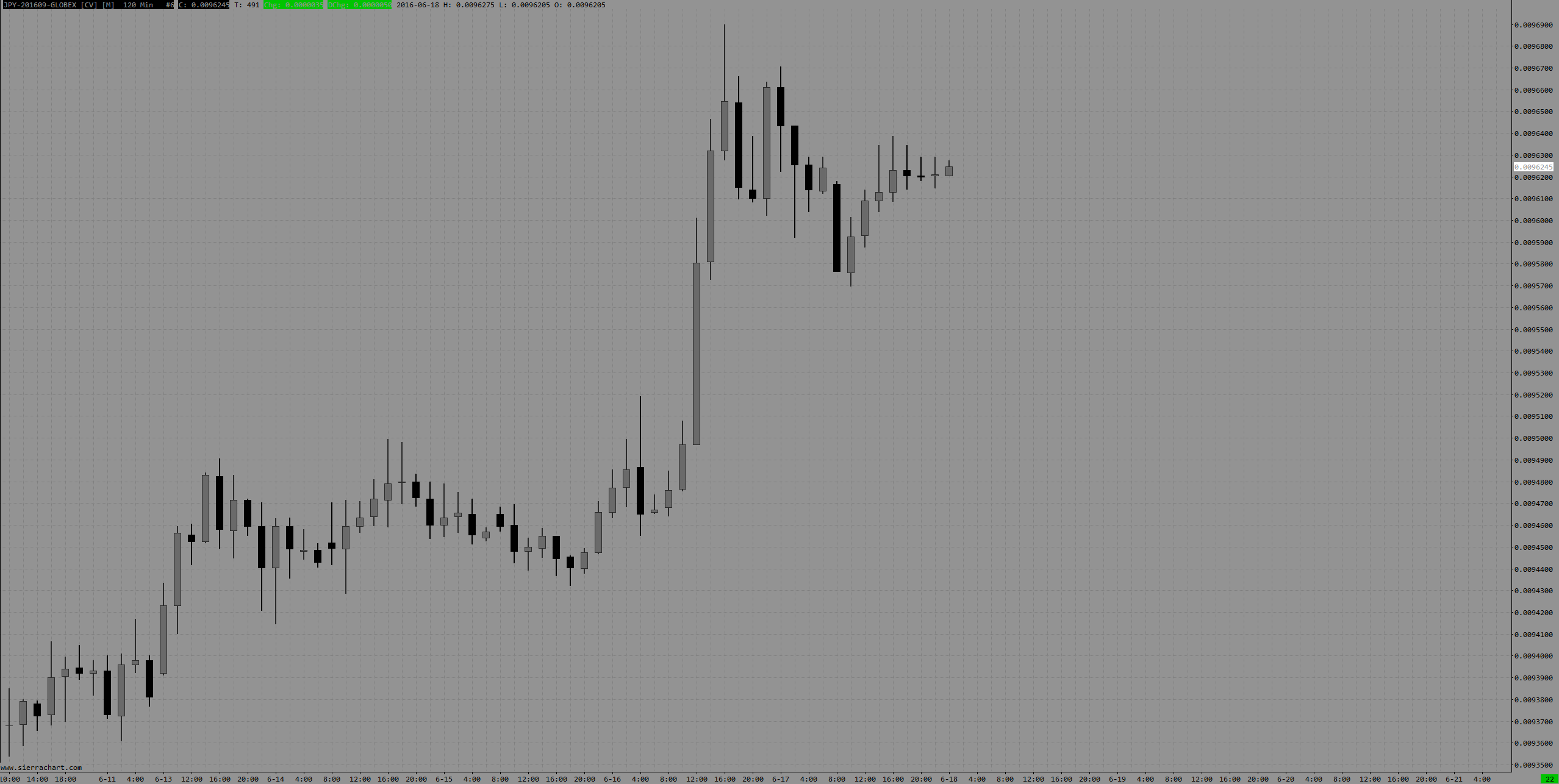

here's 3 charts for comparison -
60m 120m 240m
thanks
imageJPY-201609-GLOBEX [CV] [M] 60 Min #6 2016-06-18 00_05_04.png / V - Attached On 2016-06-17 14:08:35 UTC - Size: 115.38 KB - 380 views
imageJPY-201609-GLOBEX [CV] [M] 120 Min #6 2016-06-18 00_04_5.png / V - Attached On 2016-06-17 14:08:54 UTC - Size: 107.33 KB - 471 views
imageJPY-201609-GLOBEX [CV] [M] 240 Min #6 2016-06-18 00_05_3.png / V - Attached On 2016-06-17 14:09:20 UTC - Size: 100.42 KB - 456 views

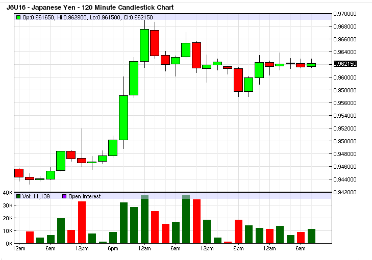

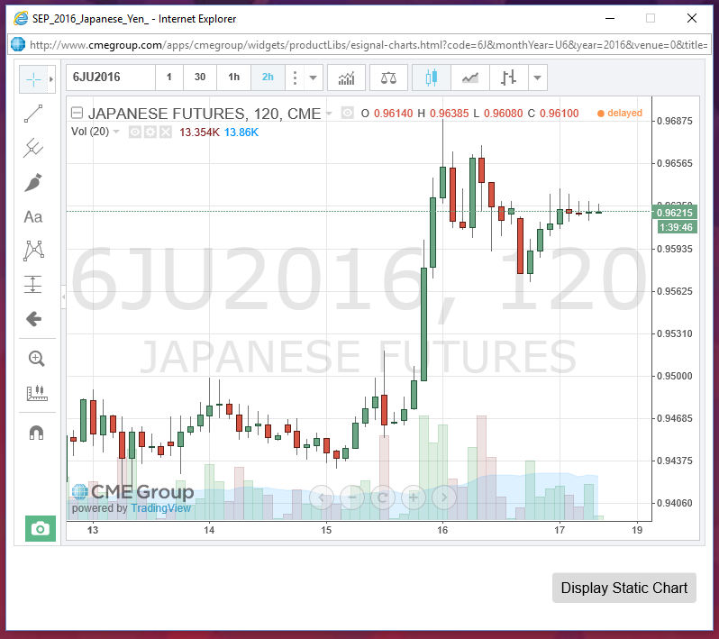

this is where i am getting confused -
i go to cme site and pull up chart of jpy 120m, looks same as mine.
then i pull up jpy 120m chart on bar chart, where get my real time dat feed from and it looks different.
imagecme jpy 120m.PNG / V - Attached On 2016-06-17 14:27:39 UTC - Size: 79.9 KB - 409 views
imagebarchart 120m jpy.PNG / V - Attached On 2016-06-17 14:28:09 UTC - Size: 31.42 KB - 397 views
