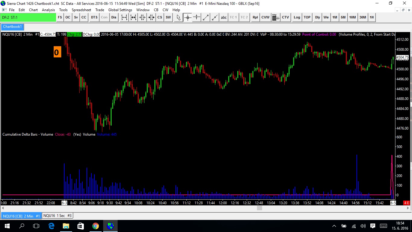

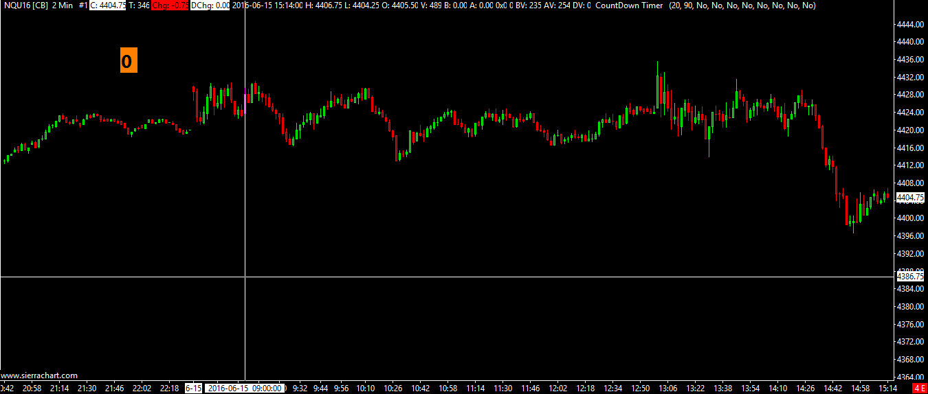

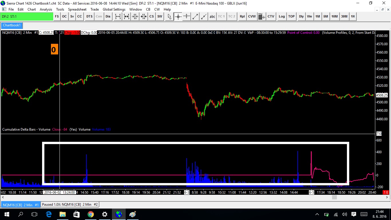

I have problem, i downloaded windows 10 and some studies doesnt work correctly, especially I mean cumulative delta bars-volume (picture) and countdown timer is lagging about 2 - 5 sec, i checked data I know that i have tick data and tried to set system datebut still doesnt works. can you help me pls?thank you

For Cumulative Delta Bars, follow the instructions here to update the Symbol Settings:
Global Symbol Settings: Update Symbol Settings
After that re-download the data in the chart with Edit >>Delete All Data and Download
The problem with the Countdown Timer is because your computer's clock is not set accurately:
https://www.sierrachart.com/index.php?page=doc/doc_TechnicalStudiesReference.html#s201_InaccurateCountdownTimeValue

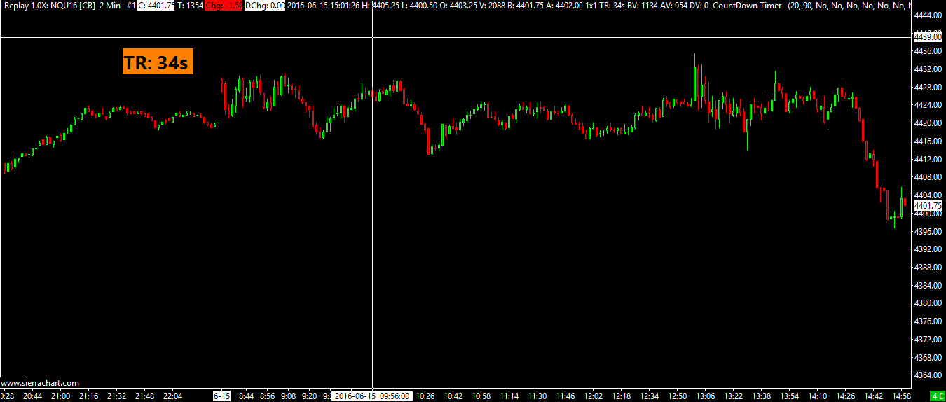

Jeliman - Posts: 16
did you mean snapshoted picture like this? thank you very much

We apologize. We gave you the wrong link. This is the correct one:
Anyway, we can see what the problem is. You are not receiving the real-time data, which you will not because the data feed is not active on your account so the Countdown Timer will show 0.
