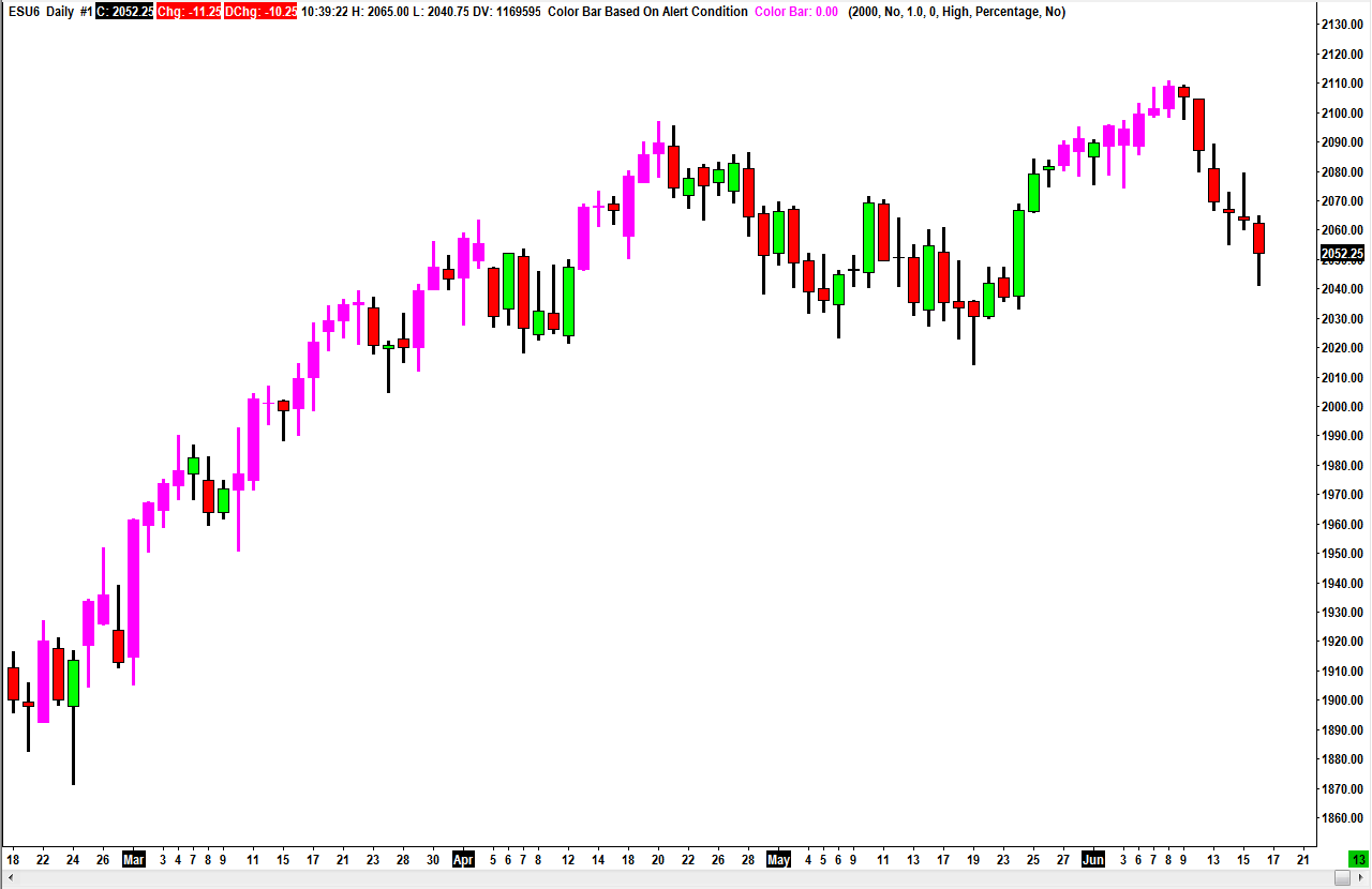

Tom, one more question - attached is image showing this formula:
H>MAX(H[-1],H[-2],H[-3],H[-4],H[-5],H[-6],H[-7],H[-8],H[-9],H[-10],H[-11],H[-12],H[-13],H[-14],H[-15],H[-16],H[-17],H[-18],H[-19],H[-20])
Basically: H > last 20 bars' high.
Do you know of a way to only display the most current signal, the last one? I can reduce the # of bars to calculate but that doesn't quite do it.
image1234.png / V - Attached On 2016-06-16 15:39:42 UTC - Size: 31.82 KB - 633 views
[2016-06-16 19:31:30]
Sawtooth - Posts: 4359
I don't know of a way to do it with Simple Alerts because there is no current bar Identifier.
It can be done with a spreadsheet study, using this formula:
=AND(ROW()=3,C3>MAX(C4:C23))
Row 3 is the current bar and column C is the High.
On the spreadsheet the MAX function can use a : for a range, but this syntax is not supported in Simple Alerts.
