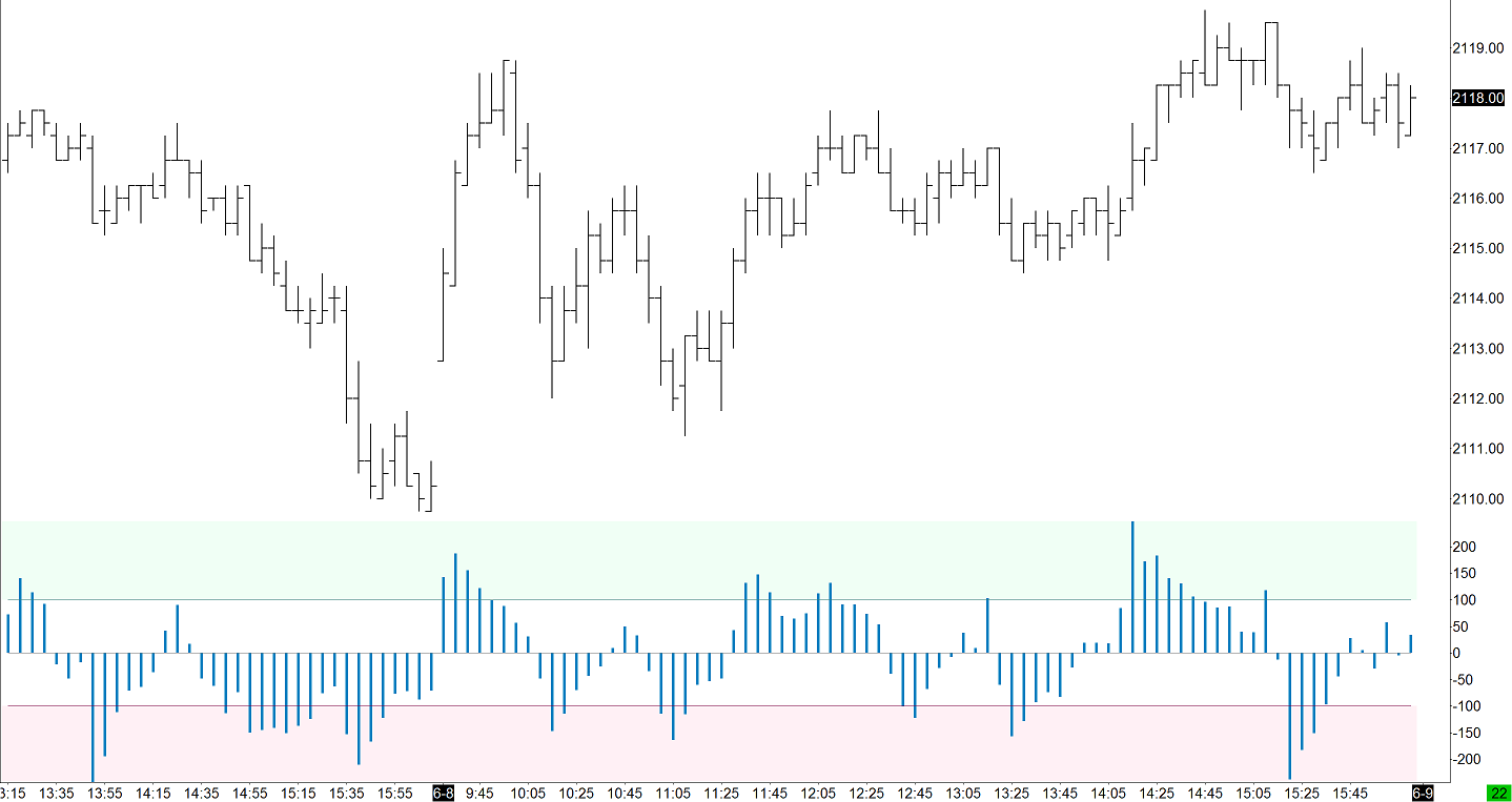

How can I color the background of a portion of a study panel ?
For example: If CCI is in panel 2, it has lines for +- 100. I want to color background above +100 and different color below -100.
I did attempt to find in the index, no luck.
Thanks for any help
[2016-06-11 16:16:49]
jackw - Posts: 57
Take a look at the attached chart. If that's what you looking for, then apply the attached study collection to a new chart to see how I did it.
imagechart1.png / V - Attached On 2016-06-11 16:15:25 UTC - Size: 46.48 KB - 461 views
attachmentCCIBackground.StdyCollct - Attached On 2016-06-11 16:15:44 UTC - Size: 18.7 KB - 533 views
[2016-06-11 19:27:04]
Willson - Posts: 176
Thankyou jackw, That is exactly what I had in mind. I will check out your study collection and learn the method and maybe can extend to more complex situations.
