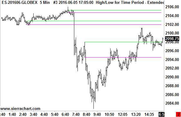

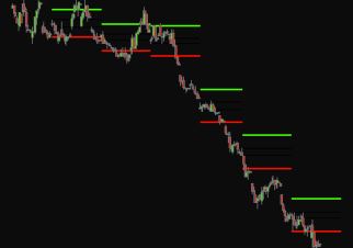

I am using several instances of this study on an intra-day chart, and would greatly appreciate it if you would add the ability to manually set the time the study stops drawing (earlier than the current default of midnight).
[2016-06-06 01:25:33]
How this works is documented here:
https://www.sierrachart.com/index.php?page=doc/doc_TechnicalStudiesReference.html#s246
[2016-06-06 20:26:59]
chisel - Posts: 25
I understand how it works, but I was wondering if you would add an option so users of the study could set the length of the time which the study lines are drawn, which is not the same as the end time of the range to draw. If I want the lines drawn for 2 hours, then I would have the ability to do so. I am not saying I want the high/low of that 2 hr. period. Currently, multiple instances of this study on a chart look like the one with the white background. I would like the option to make the chart look more like the one with the black background. The black chart is not using the same study, it's just to illustrate how the horizontal lines do not overlap each other at the same time.
