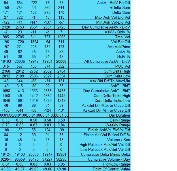

Can you help explain to me I can't really wrap my head around this. I've read the documentation but it does not explain this behavior.
It seems like Finish Ask Vol Bid Vol Diff row is just the inverse of AskBid Diff Max to Close Diff or AskBid Diff Min to Close Diff.
For example, if there were more Asks in this minutes time frame it will take the AskBid Diff Max say 89, and inverse that and it becomes the Finish Ask Vol Bid Vol Diff.
Is that supposed to be correct?

We do not think that is correct. Refer to the updated descriptions here for a better explanation:
https://www.sierrachart.com/index.php?page=doc/doc_NumbersBars.php#SubgraphDescriptions

and how can that number not be correct? If I am not altering any data
[2016-06-01 13:41:40]
toews&kane - Posts: 209
What I am getting at is I want to get the correct Finish Ask Vol Bid Vol Diff
