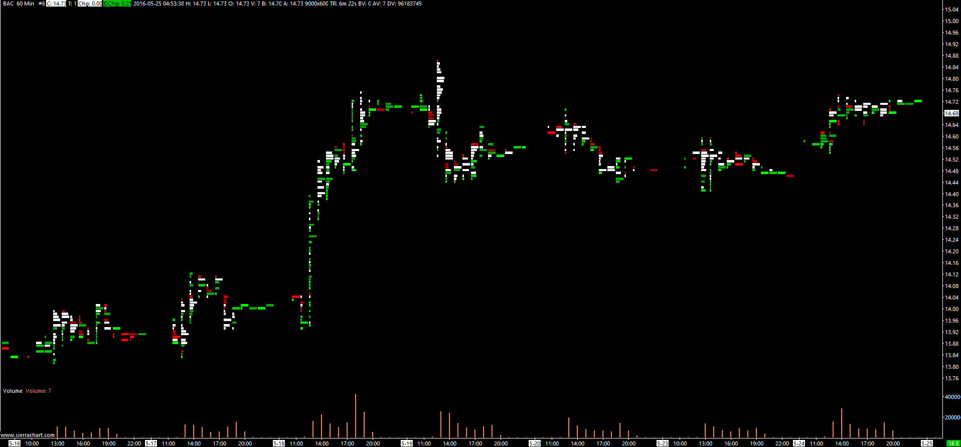

Some of the number bars have black entries for comparison what does this mean and how do I get rid of it?

http://www.sierrachart.com/image.php?Image=1464152556463.png

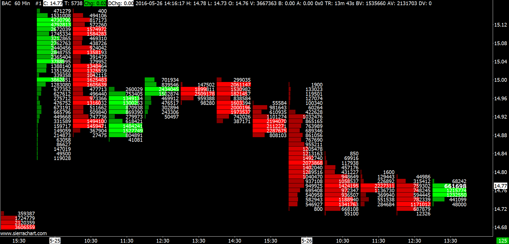

This is what we see when using the Sierra Chart Historical Data service for that symbol:
http://www.sierrachart.com/image.php?Image=1464286733656.png
Follow through the instructions here to use the Sierra Chart Historical Data Service:
http://www.sierrachart.com/index.php?page=doc/SierraChartHistoricalData.php#UsingSCHDS
When that is done, go to that chart you posted an image of and re-download the data with Edit >>Delete All Data and Download and let us know if it changes.
You really should configure the chart like we do so you can see clearly the volume at each price level.

We set this chart to show the difference between the Ask volume and Bid volume both as numbers and horizontal bars at each price level and we see no blank price levels:
http://www.sierrachart.com/image.php?Image=1464473841235.png
And we do not know how you have configured the Numbers Bars study. That is an extremely complex study with numerous options.

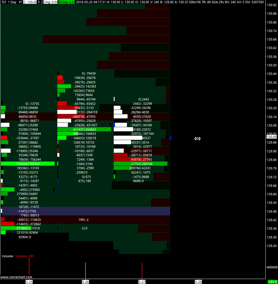

http://www.sierrachart.com/image.php?Image=146466748796.png
I actually showed the number values it turns out the black bars are equal bars. Im posting just in case anybody else wants to look it up
