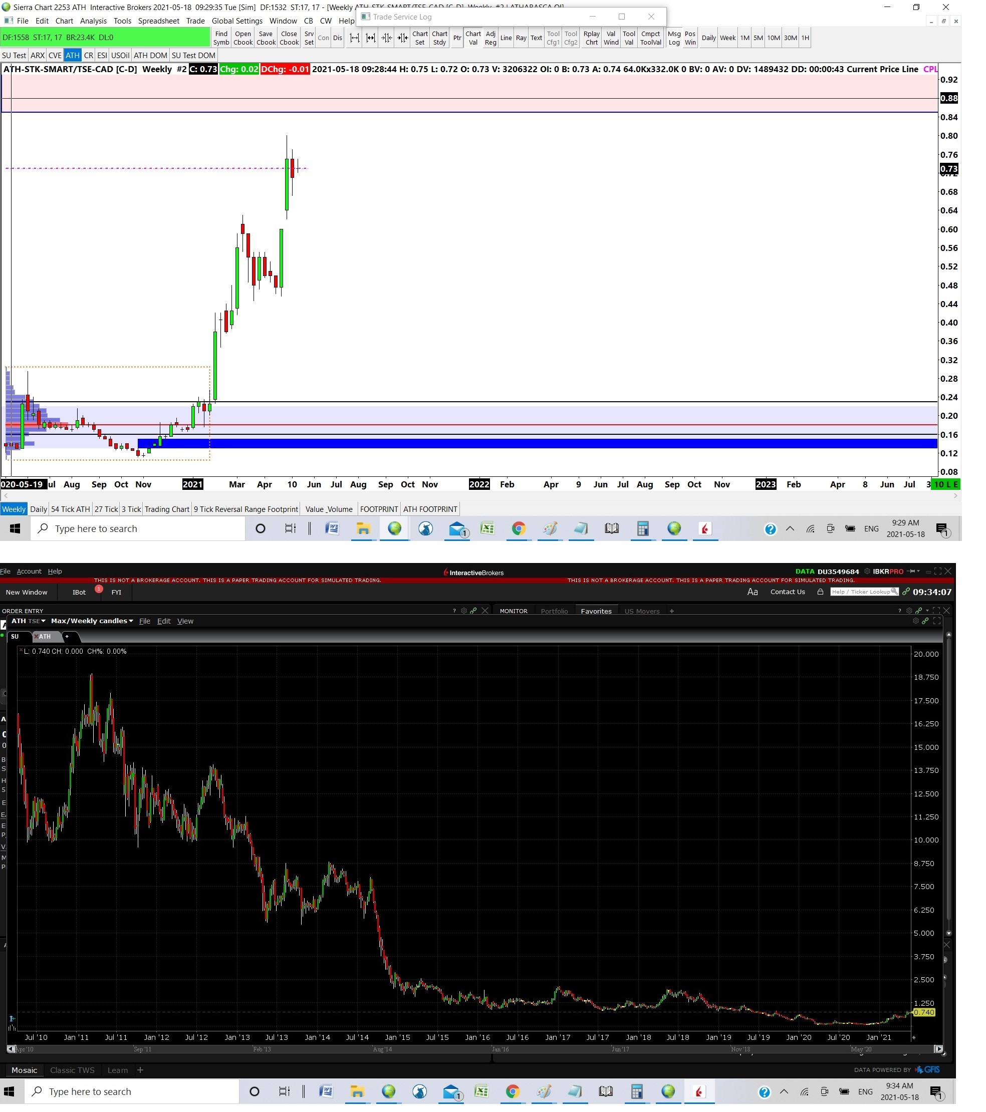

I have a IB market subscription for the TSE Level 2 data and am connectioned to Seirra Charts.
When I try to chart some TSE stocks I am only getting 3-4 days of inter-day tick data and maybe 9 -12 months of historical weekly data.
I attached some screenshots of a Weekly chart and a inter-day Range chart.
Please Help !
Kind Regards,
Daniel
My sierra charts is connected to IB for TSE Level 2 market data.
I have trouble downloading more than a couple days of interday data about 12 months of historical data.
I can go on IB TWS and chart 20 + years of historical data.

[2021-05-20 20:46:58]
We have a Toronto Stock exchange data available through the Sierra Chart Historical Data Service:
This is drastically more reliable than what Interactive Brokers offers.
You can find the complete symbol lists here for TSE:
https://www.sierrachart.com/index.php?page=doc/SierraChart_RealTime_And_Historical_Symbols.php&SymbolsPage=Stocks
You definitely cannot trust what Interactive Brokers is telling you about the problem. For example, you can get more data within their own charts than is allowed through the API.
However, you need to follow the instructions here to access more historical Intraday data:
Interactive Brokers Trading Service: Downloading More Days of Historical Data Directly from Interactive Brokers
Date Time Of Last Edit: 2021-05-20 20:47:43

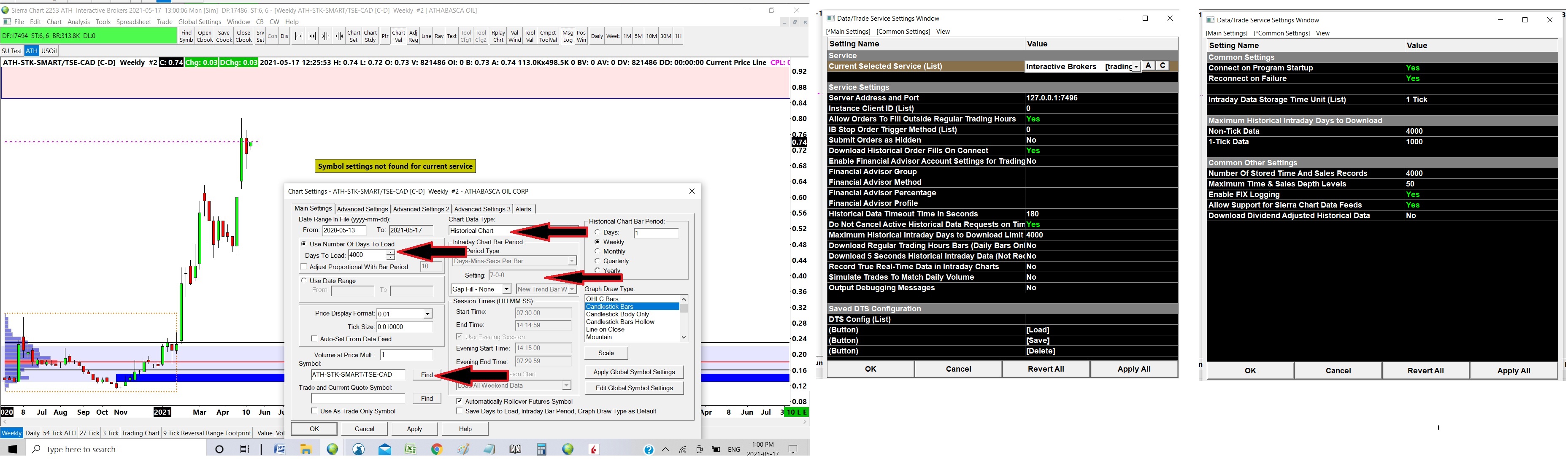

I followed your instructions.

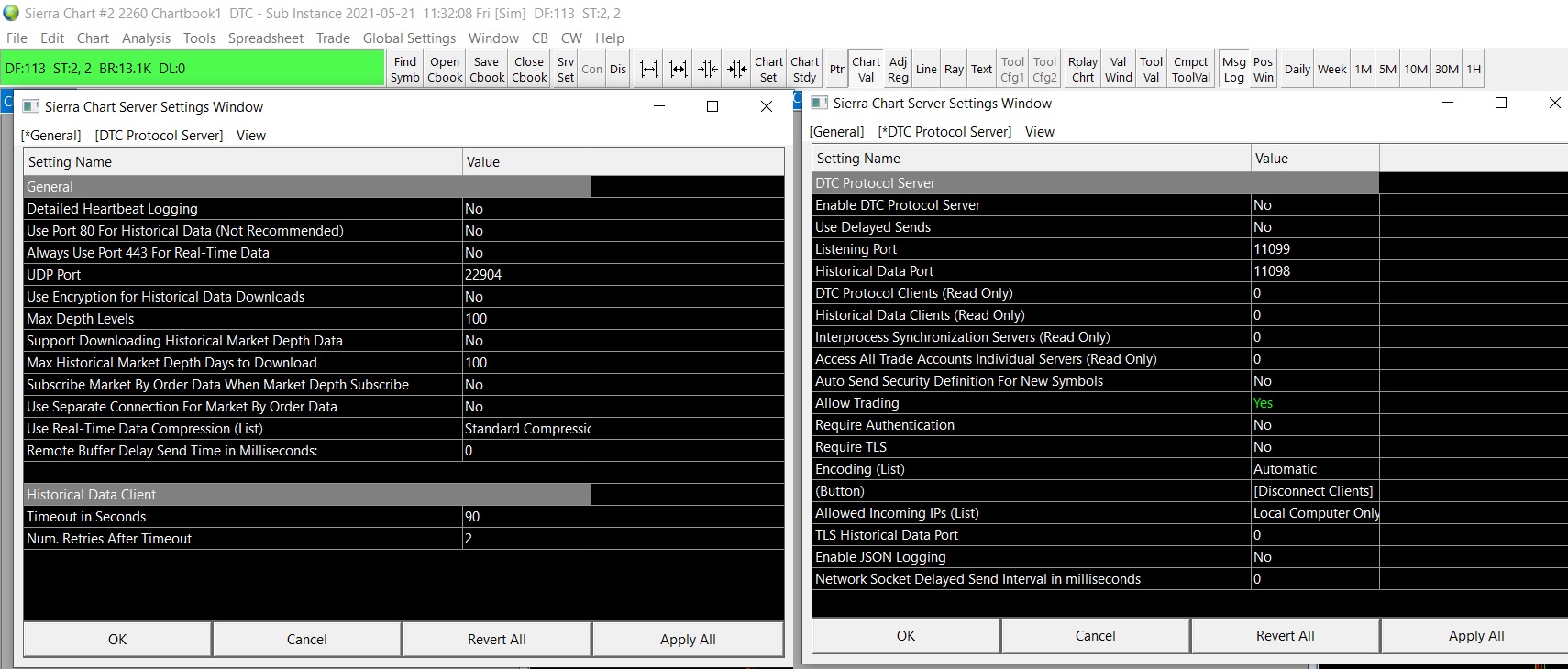

1)  From the Client, I added a New Instance called Sierra Chart #2.
2)  Followed the instructions for the Global Setting (See attachment Sierra Chart #2)
3)  The Sierra Chart #2 is connected and loading up some data BUT will not load the last 5-6 days
4) Followed the instructions for the New Instance Chart Server Setting (See attachment New Instance Chart Server Setting)

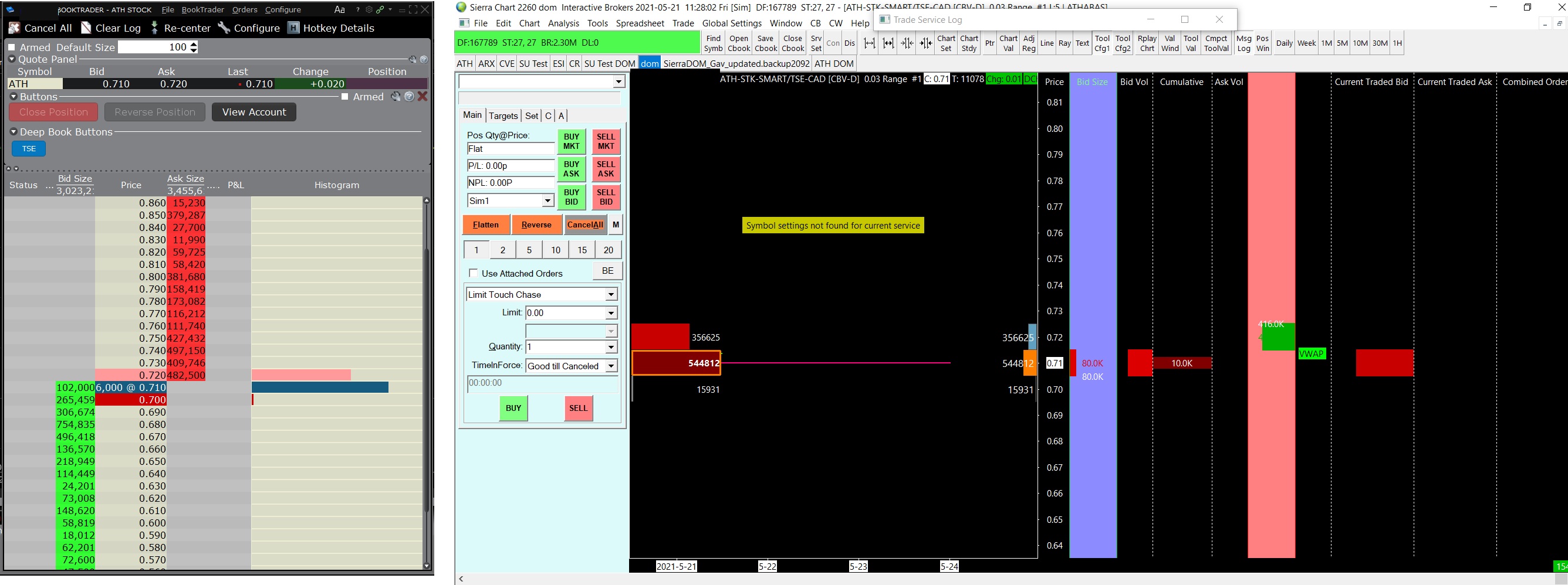

Plus, the Client is not receiving Level 2 data from Interactive (See attachment Level 2 Data)
Still need your help !

[2021-05-21 19:10:53]
You need a completely separate installation of Sierra Chart set to use SC Data-All Services. Documentation for this:
Using Multiple Data and Trading Services at the Same Time
We cannot help with market depth data from Interactive Brokers. We simply do not provide any technical support for Interactive Brokers and that is well disclosed.
