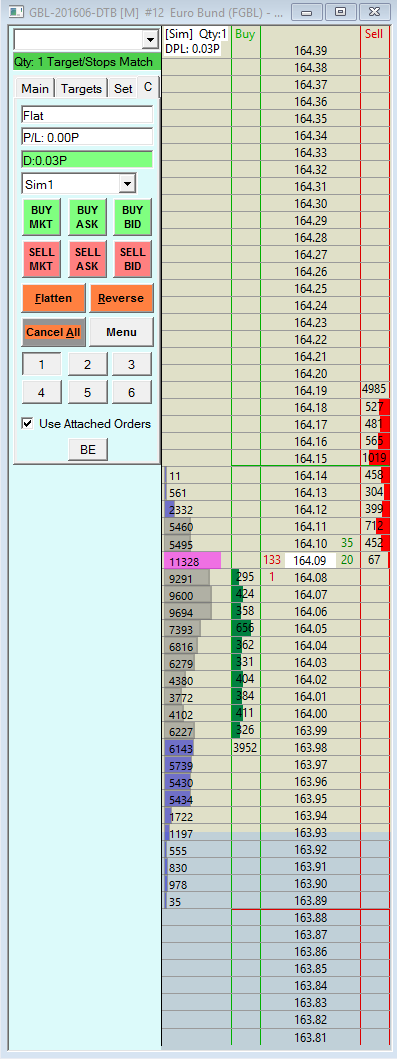

I am using version 1411 and the SC data feed. When I start SC, I notice that the price and background (grey color) in the DOM are not matching up with each other. Please se picture 01 attached.

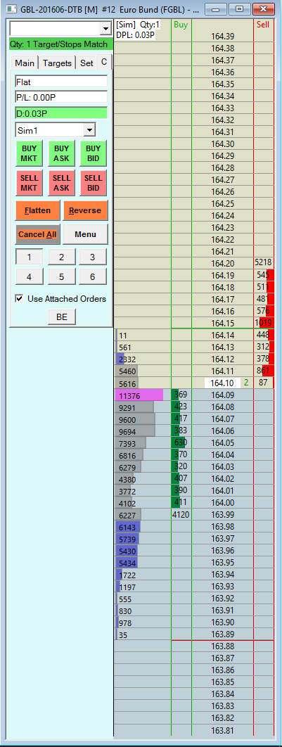

When I disconnect and reconnect it works again (picture 02).

[2016-05-13 09:32:14]
There have been similar problems with the Barchart data feed which is the data feed this originates from. We thought they were solved by now.
We checked the data feed and we are not observing this problem now but it does not surprise us that something like this did happen.
Let us know when you see it again and we will check. We do not believe it is a problem within Sierra Chart itself. That would be extremely unlikely.
