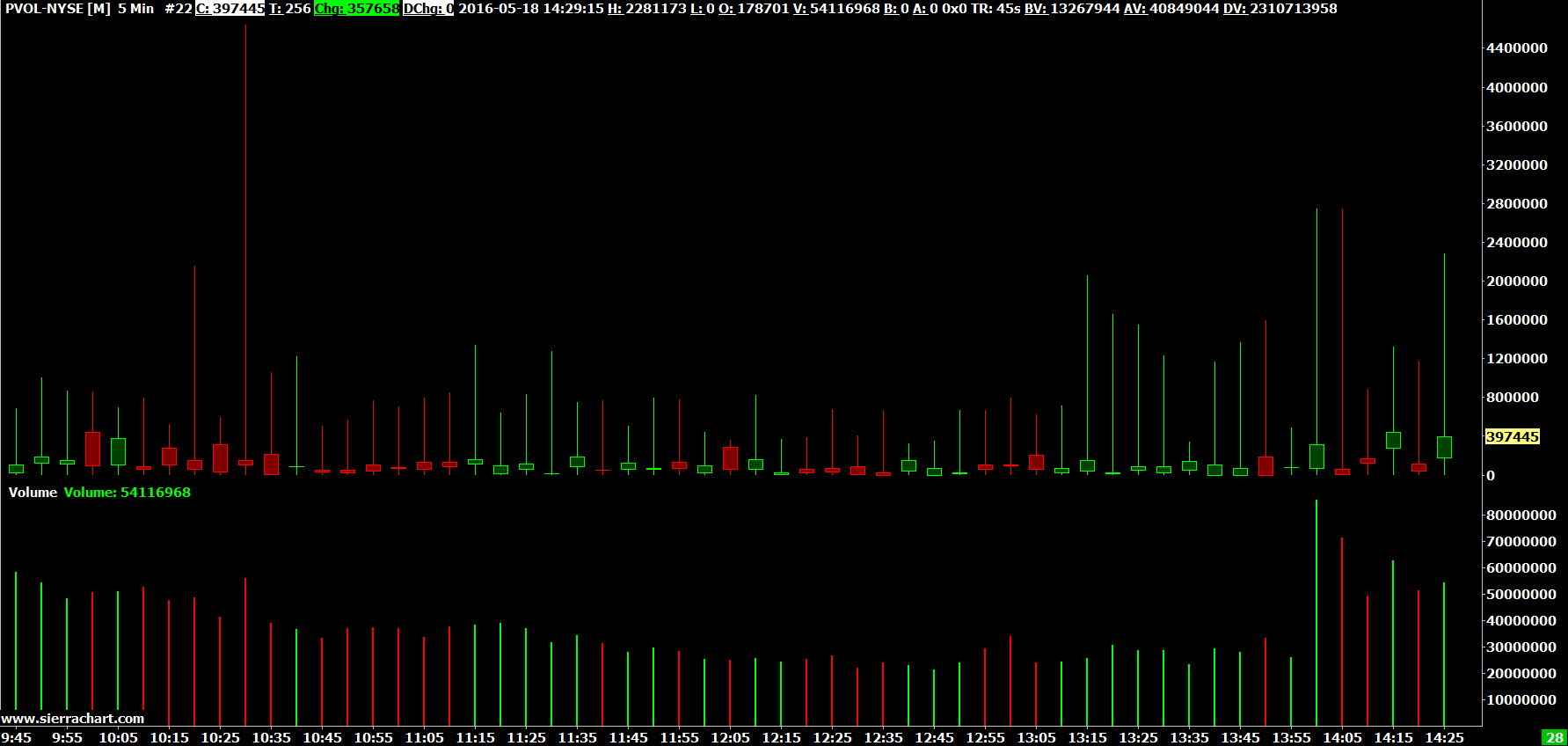

User995189 - Posts: 16
Thanks! I restarted the platform and now I am seeing it...
However I have a question: it this is a volume chart, why are red candlesticks on the chart? Shouldn't all be green?
[2016-05-18 19:09:08]
This is explained in detail here for the symbol:
http://www.sierrachart.com/index.php?page=doc/SCMarketStatistics.php#Symbols
You need to look at the Volume study to see the volume.
[2016-05-18 20:24:23]
Hi
I didn't understand quite well what PVOL is... However, if I apply the VOLUME study to the PVOL, what I see is the total volume of the bar, regardless of the the timeframe?
[2016-05-19 00:24:09]
Correct.
[2016-05-19 06:43:18]
OK, thank you!

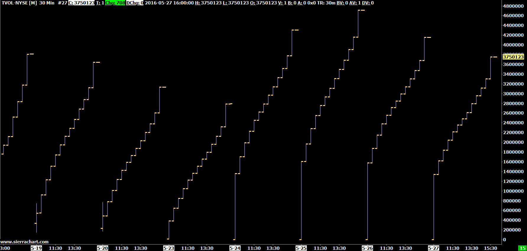

Hi
I did what you indicated (deleting and downloading again the data) and it seems that in the daily chart, for days before May 24th the low of the day is still not zero. For the 24th and after days, the low of day seems to be ok at zero
http://www.sierrachart.com/image.php?Image=1464557495944.png
If I see the same chart at 30 min timeframe, the low of day definitely is not zero on any day as seen on the following chart
http://www.sierrachart.com/image.php?Image=1464557853512.png
thanks!!
Camila
[2016-05-29 22:17:25]
There is nothing we can do about the data before May 24. The volume will not start at 0.
For the 30 minute Intraday chart, re-download the data with Edit >> Delete All Data and Download.
If you still have a problem, make sure the Chart >> Chart Settings >> Session Times >> Start Time is set to 9:30:00 US Eastern time or the equivalent.
This is what we see:
http://www.sierrachart.com/image.php?Image=1464560130527.png
Date Time Of Last Edit: 2016-05-29 22:20:04
ok, thanks, so we are ok on the daily chart....
As for the 30 min chart this is what I see,... Total volume for last Friday is the same as yours... However it doesn't start at zero...
http://www.sierrachart.com/image.php?Image=1464564810177.png
Camila
[2016-05-30 00:34:26]
This is not making sense.
How did you re-download the data in the chart?
What are the Chart >> Chart Settings >> Session Times set to?
Is Chart >> Chart Settings >> Advanced Settings >> Allow Zero Values enabled?
[2016-05-31 13:57:05]
I checked my start time and it was set to 8:30:01... And that correct the initial value of zero!
Now, the total volume for Friday differs a little from yours... but it is ok
http://www.sierrachart.com/image.php?Image=146470300287.png
Thanks you so much for you help! :)
Camila
