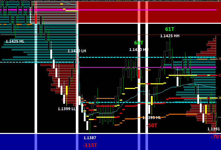

My question is, if someone from Sierra would kindly help with, one of your indicators works quite well with what I need although it posts a line vertical and gives no option for horizontal. Using COLOR BACKGROUND BASED ON ALERT CONDITION, is there a way to change the vertical line to a horizontal line...

Is there a reason why? I feel that was a sheer answer? This would greatly benefit this in my trading, although is there something else that will allow one full renko bar to be horizontally highlighted?

This can be done using the Color Bar Based On Alert Condition study, if the price is one of the OHLC, or one of its averages. If you want to color the background of a price range at a certain bar, or put a dash at a custom price at a certain bar, it could be done with the Spreadsheet Study study. If you want the details, post here again. Date Time Of Last Edit: 2016-05-10 05:58:42

Add the Spreadsheet Study study -Set the Chart Region to 1 -Check 'Draw Study Underneath Main Price Graph' (optional) -Set the Draw Style of K(SG1) to Dash, set all other Draw Styles to Ignore. -Press OK and OK On the spreadsheet: -Put a formula like this in cell K3: =IF(YourAlertFormula,YourLineValueFormula,0) You can use your current Simple Alert formula in the spreadsheet formula if you use this conversion: Current bar: ID1.SG1 > ID1.SG1@3 Previous bar: ID1.SG1[-1] > ID1.SG1@4 |
