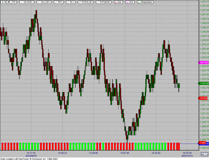

Could you please give instructions how to build an indicator (if possible) in SC as described below:
"a multi-time frame set up for the ES that uses a 630 tick to generate bias and a 70 tick chart to generate the signals.
A trend indicator is used to generate bias on the 630 tick chart. To build the trend indicator, you will need the following:
- 10-period WMA using the 630 tick chart as a data source
- time series forecast (TSF) indicator with a period of 5 and a projection of 18 applied on the above 10-period WMA.
Plot this indicator on a 70-tick chart as a histogram. You will end up with something like the image below"
My main problem is the time series forecast, your suggestions are much appreciated. thank you

Try using the Moving Linear Regression study for the TSF.
http://www.barchart.com/education/std_studies.php?what=int_time_series#study

We need to add Time Series Forecast study. We will have that done later this week.
