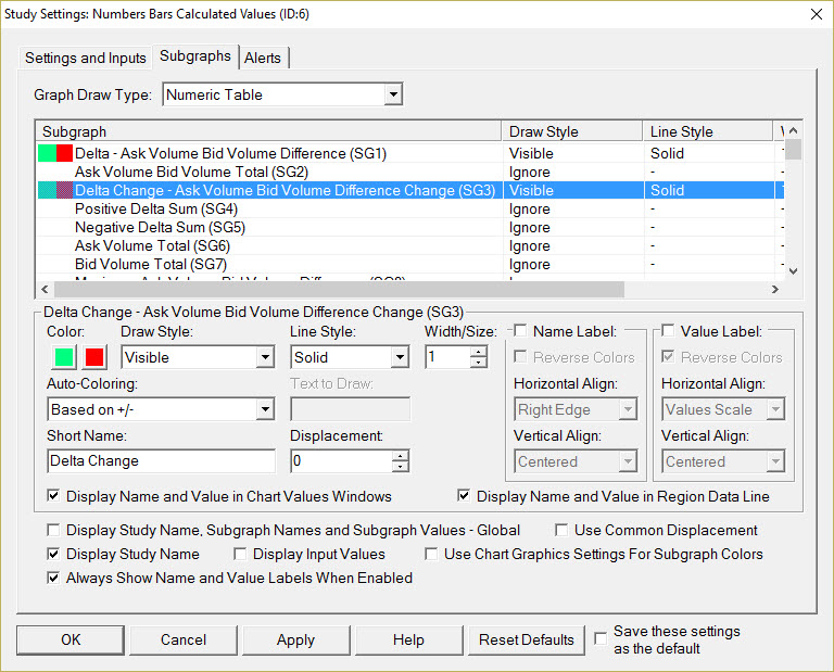

Folks - Is there a way to plot "Ask Bid Volume Difference Change"(SG3) as a bar on the bottom of chart instead of just the values.
Pls. see attached
image2016-05-06_15-15-30.jpg / V - Attached On 2016-05-06 19:37:27 UTC - Size: 218.51 KB - 529 views
[2016-05-07 03:08:40]
User50927 - Posts: 91
You can use the "Study Subgraphs Reference" study. Select "Ask Bid Volume Difference Change" for "Input Study 1" and then set the Draw Style for "Input Study 2" to Ignore under the Subgraphs tab.

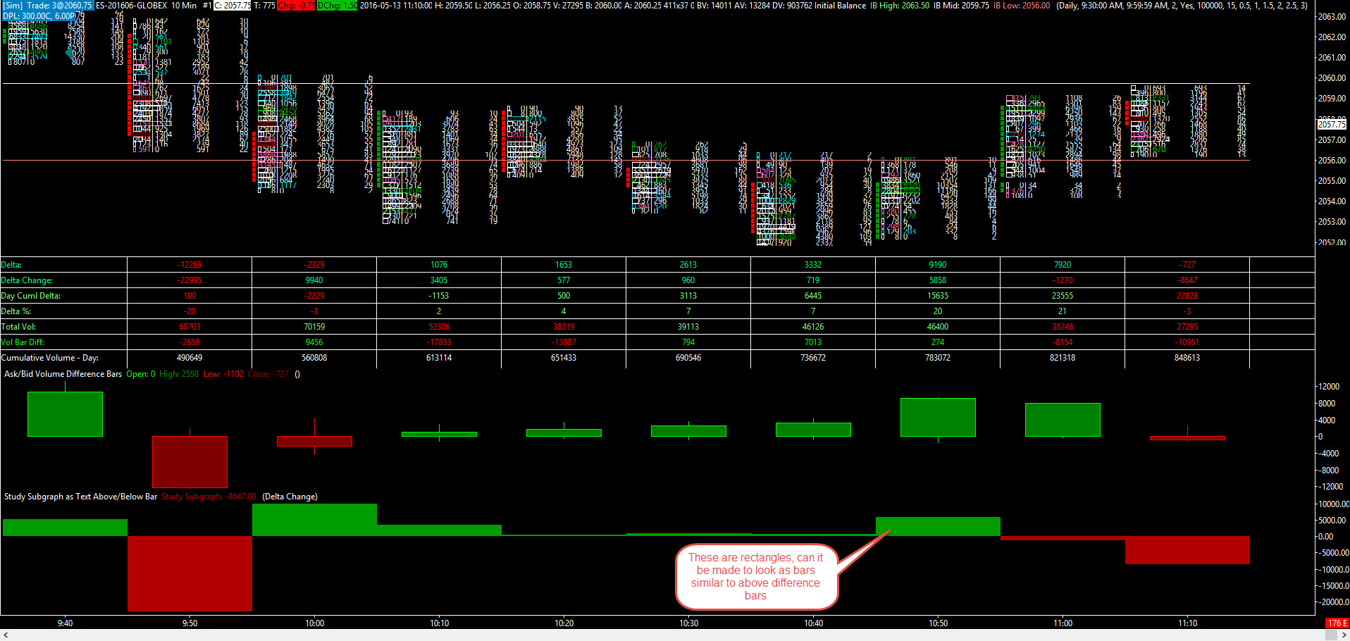

Was able to find this study in the latest beta/pre-release . however on setting up , it shows as a bar (not visually same as candle) and I had to increase bar width to 30. This is not optimal.
Is there a way to show this value visually like a candle similar to the existing delta cumulative bars study?

[2016-05-13 15:33:55]
SK - Posts: 33
Am not asking for price style bars. Pls. check attached. Am looking for a chart region with bars but the bars are not visually in a bar format. Had to select a rectangle to give a somewhat similar look and feel of a bar, however they do not line up well. Tried almost all available options in the draw style dropdown but none of them show like a TRUE bar.
image2016-05-13_11-25-49.jpg / V - Attached On 2016-05-13 15:31:55 UTC - Size: 504.64 KB - 488 views
[2016-05-13 17:36:43]
What you are looking for are bars that consist of Open, High, Low, Close values.
The new study is not designed to do this whatsoever.
The implementation of what you are looking for is complex. However, it can be done. It can be done by using this study:
https://www.sierrachart.com/index.php?page=doc/doc_TechnicalStudiesReference.html#s149
