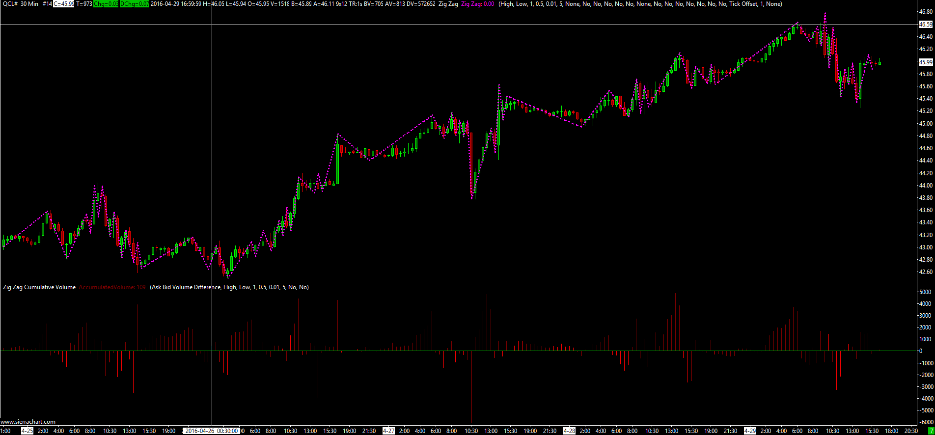

can i find in sierra zig zag indicator with numbers that represent the delta volume (ask minus bid volume)
similar to the image i'm sending.
thanks.
avi.
imageUntitled2.png / V - Attached On 2016-04-30 06:23:13 UTC - Size: 281.61 KB - 1961 views

[2016-04-30 16:35:39]
User345334 - Posts: 23
thank you so much.

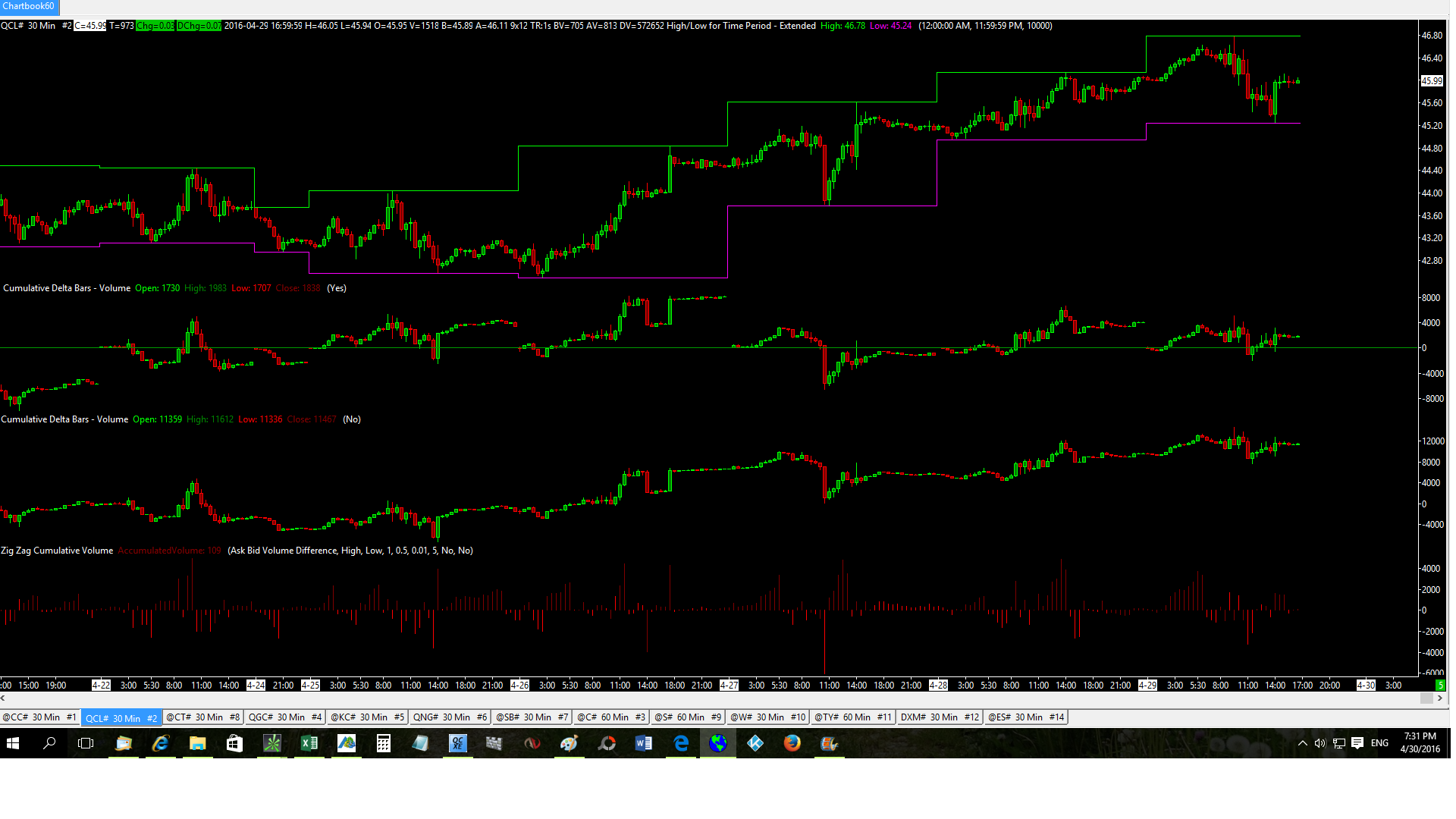

i add the study and set the Volume to Accumulate >> Ask Bid Volume Difference.
but i want this study on the main chart with the data and the zig zag line, how i change it?
thanks.
avi.
imageUntitled2.png / V - Attached On 2016-04-30 16:35:24 UTC - Size: 156.35 KB - 1631 views
[2016-04-30 18:09:51]
That chart image is not acceptable.
We will only accept a chart image posted following the instructions here:
You also need to use the study named "Zig Zag".
[2016-04-30 18:44:07]
http://www.sierrachart.com/image.php?Image=1462041560792.png
i add the zig zag as you can see in the image but still don't see the numbers (ask-bid) above and below the zig zag
