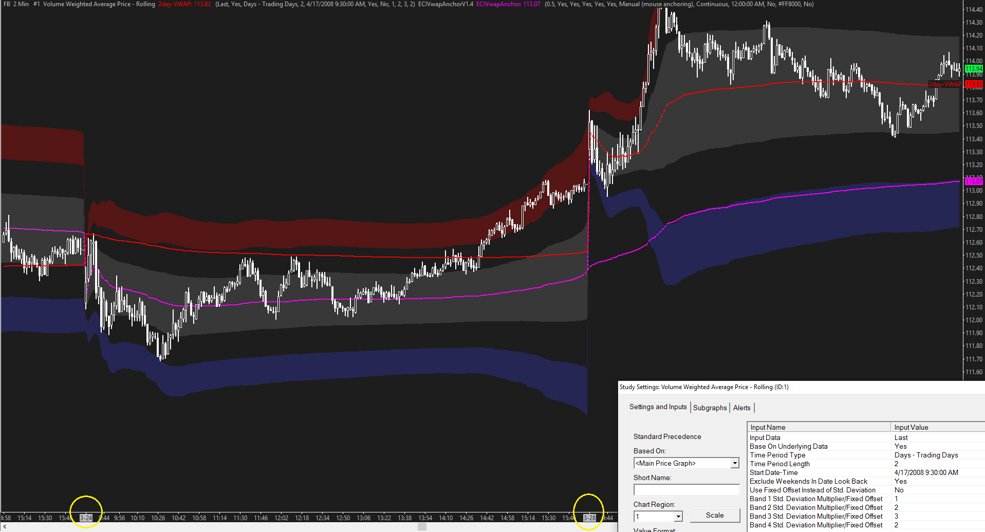

The rolling VWAP study has the input to "exclude weekends in date look back", however, it's not coded to factor in Holidays, eg Good Friday, March 25, so weekends with an extra day will falsify the study. See pic attached using a 2day VWAP in Red, and the pink line showing what a 2day VWAP should have looked like from the 24th.
This is problematic to hard code since the dates can change each year, and global markets have different holidays etc. However, is possible to add multiple manual inputs to the study so users have the ability to select which additional days they want to exclude from the calculation?
Also, could the input to "exclude weekends in date look back" be added to the Volume by price/ Volume value area lines study.

Never been added? You already have this setup. I just don't want weekend dates to be included, you know, days when stocks don't actually trade. Does that make logical sense?
I'm referring to constructing a volume by price study that, for example, is based on the last 2 days( So it will include data from the previous day & the developing day). You can already create this now, however, as far as I'm aware the weekends can not be excluded from the calculation- Hence, why I'm asking if you can please add the input to "exclude weekends in date look back" as you have done with the rolling vwap study.
We also need to update VWAP-Rolling study to automatically skip periods where there is no data, by using a percentage.
