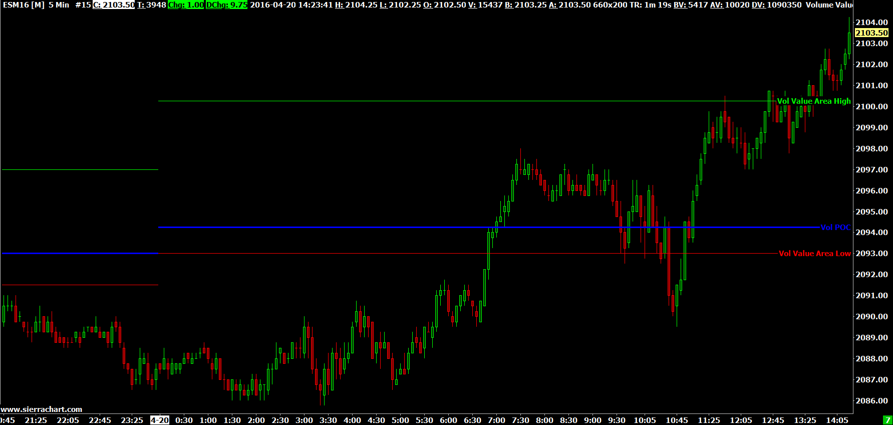

We apologize for the delay. We see 3 horizontal lines on that chart and we assume they are the Volume Value Area and Point of Control lines.
So it is not clear what the problem is.

I do not know how you can see three lines in the screenshot, I see only one blue line. The client wants to use the Value Area, not the Interactive Scale Move and this last one is extremely complicated to explain. I just would like to know how comes that in my demo or other prospect can see the Value in the correct way and only this client cannot. Is there something to check maybe that she did not check?

We are referring to the green and red lines.
Here is an example:
http://www.sierrachart.com/image.php?Image=1461176623305.png
Everything looks correct to us. Enable the Name Labels for the Volume Value Area Lines Subgraphs.
