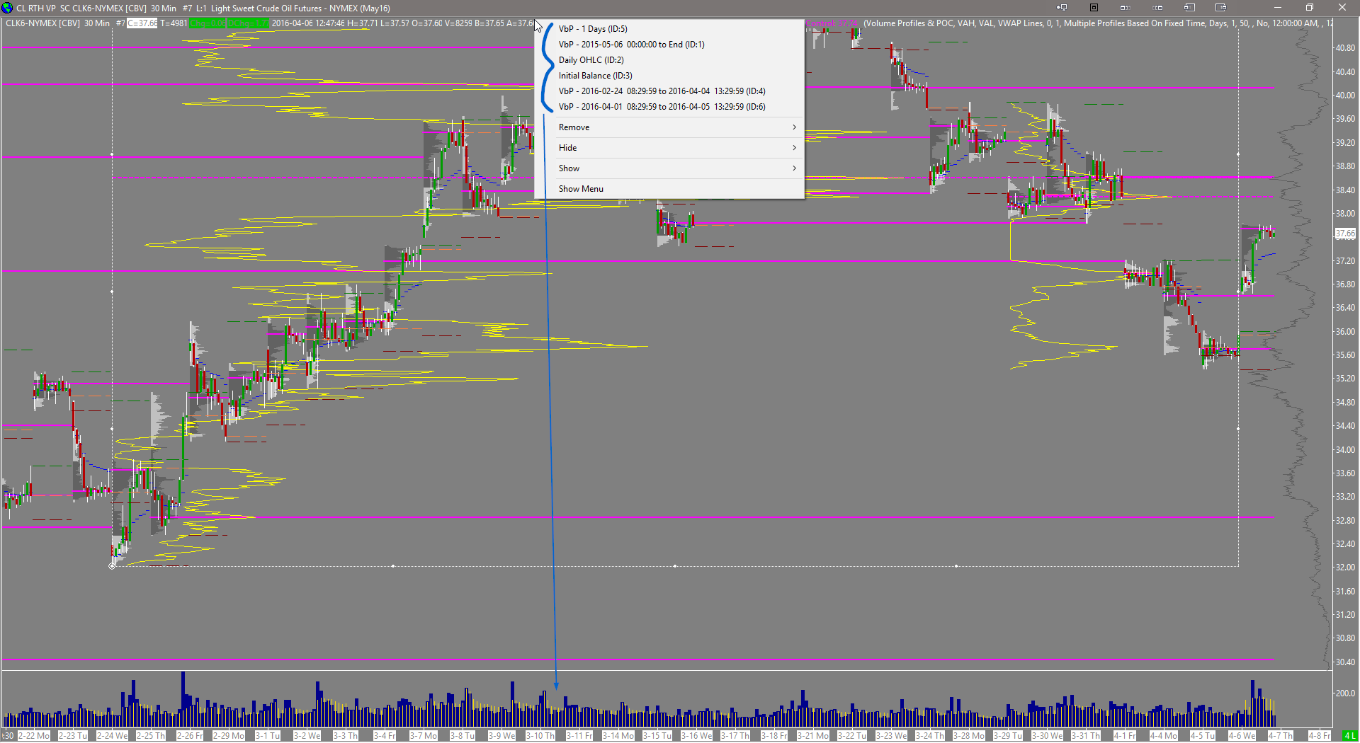

kinghat - Posts: 120
it is just simply not showing for some reason.
imageSierraChart_2016-04-06_12-47-47.png / V - Attached On 2016-04-06 17:49:00 UTC - Size: 109.04 KB - 435 views

And what does the documentation say about this?
One thing we should add is that if you have hidden the Region Data Line for a particular Chart Region, then you will not be able to access that menu for the studies in that particular Chart Region.

[2016-04-06 19:35:16]
No. The documentation was updated to explain that menu is only for the studies within the same Chart Region you are right clicking in. The other studies are in a different Chart Region. But you cannot access those through a shortcut menu because you have hidden the Region Data Line.

[2016-04-06 19:38:26]
Just right-click in the Chart Region where the studies are and you can access the settings through the Study Settings submenu.
