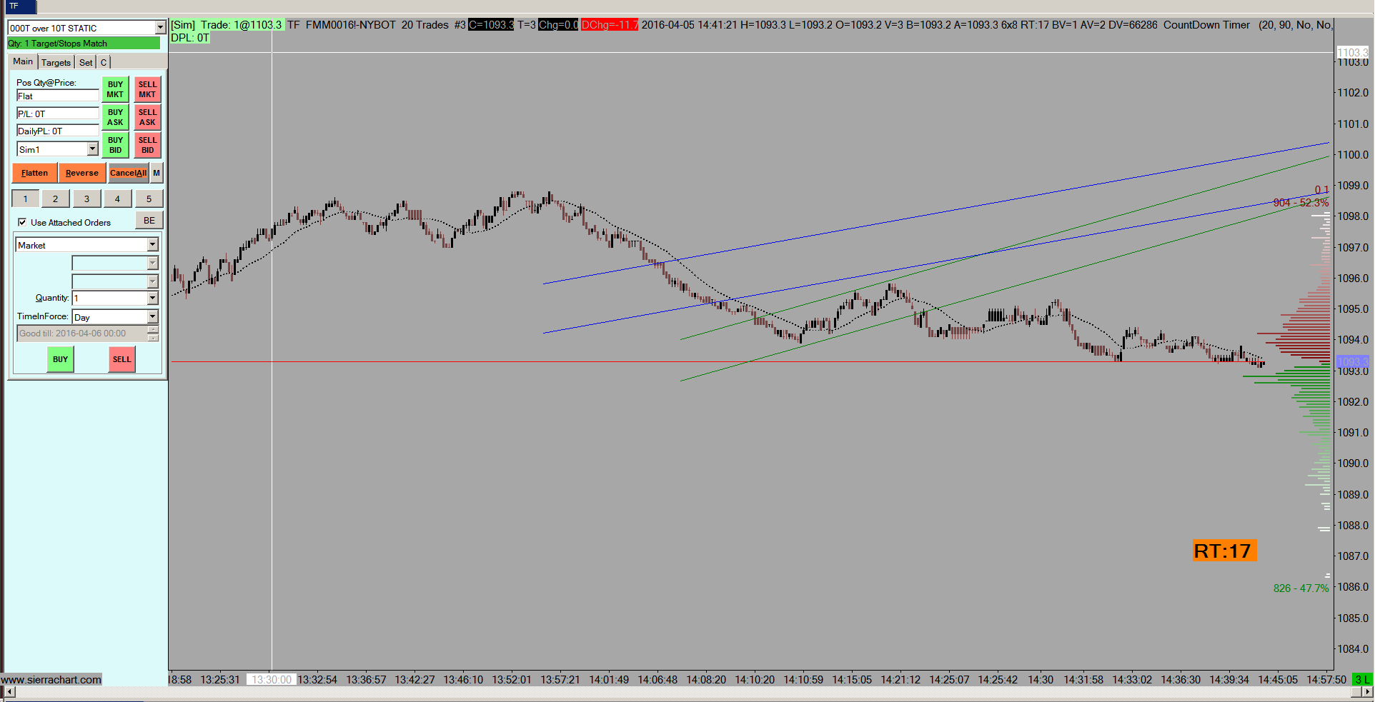

As an example: Select a "parallel rays" drawing "copy and move". Begin to move it around the screen, it will recalculate the angle of the lines such that they are different from the original. In this example, even the spacing between the lines will change. It is as if the defining 3 points are shifting (recalculating). Oddly enough the problem seems to be more prevalent when applied to a fast chart, such as a tick or volume chart where bars are printing more quickly.

User92763 - Posts: 14
http://www.sierrachart.com/image.php?Image=1459885282846.png
The screen on the right is where the problem is occurring. The green parallel rays are the original. The blue parallel rays are those that have been "copy and move".
[2016-04-06 01:46:51]
We will patch this problem in the next release, but can you tell us what you have Global Settings >> Data/Trade Service Settings >> Intraday Data Storage Time Unit set to?

[2016-04-06 18:57:39]
It needs to be set to 1 Tick.

[2016-04-06 22:45:24]
Yes, but to solve this problem you do need to use 1 Tick.
There were internal changes recently with how Chart Drawings are mapped to bars with repeating timestamps.
This problem will not occur when the Intraday Data Storage Time Unit is 1 Tick.

[2016-04-07 10:43:56]
This will be solved in the next release.
However, it should be solved if you re-download the data in the chart with Edit >> Delete All Data in Download.
If not, we are not sure why but just wait until the next release.
