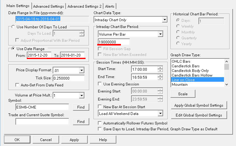

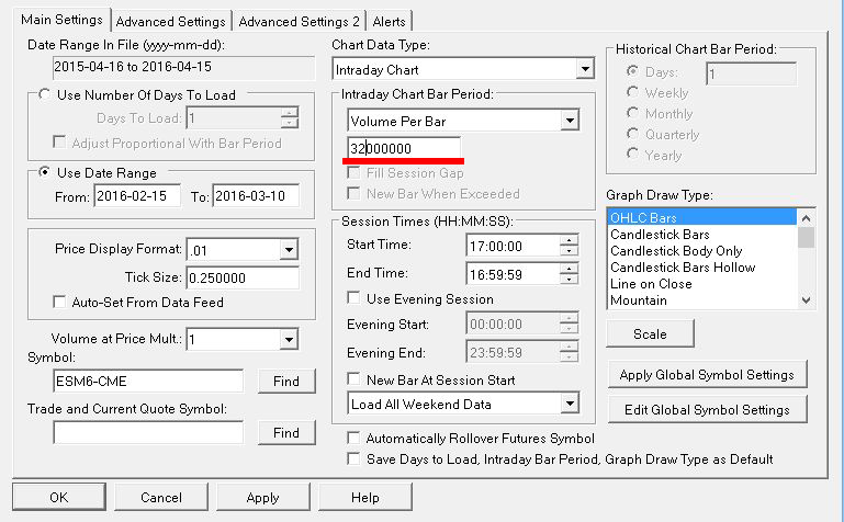

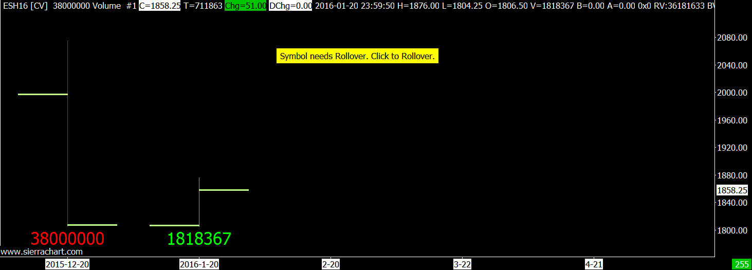

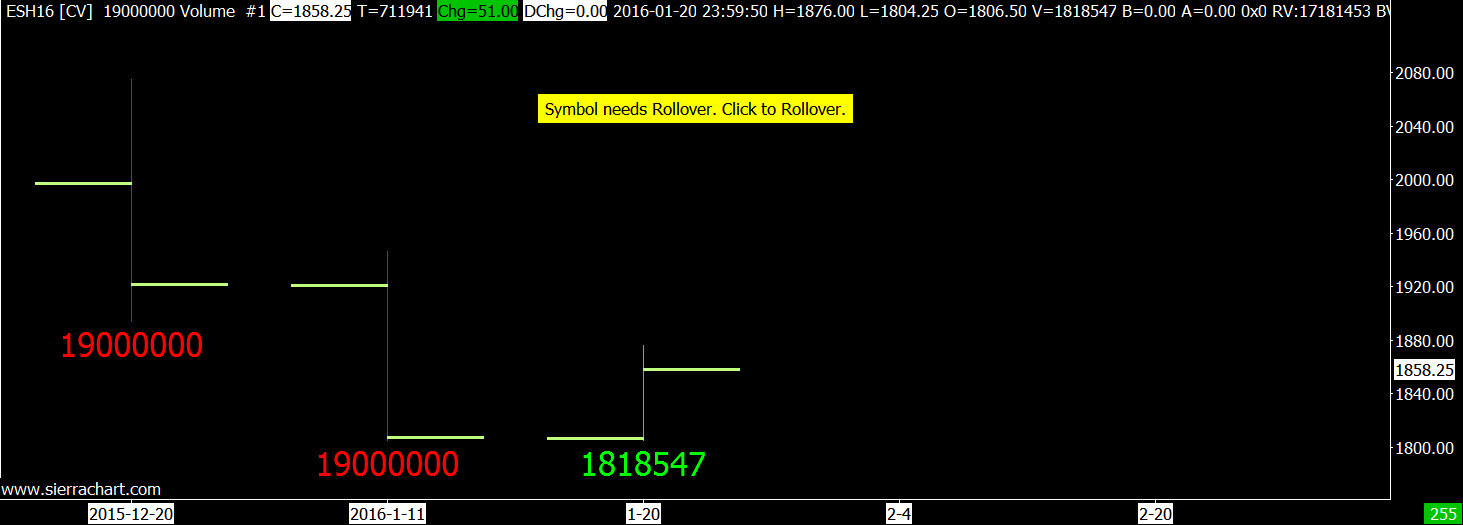

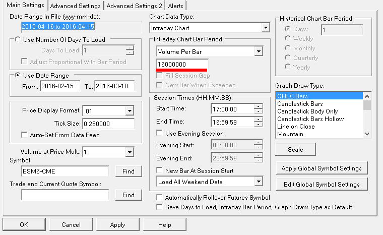

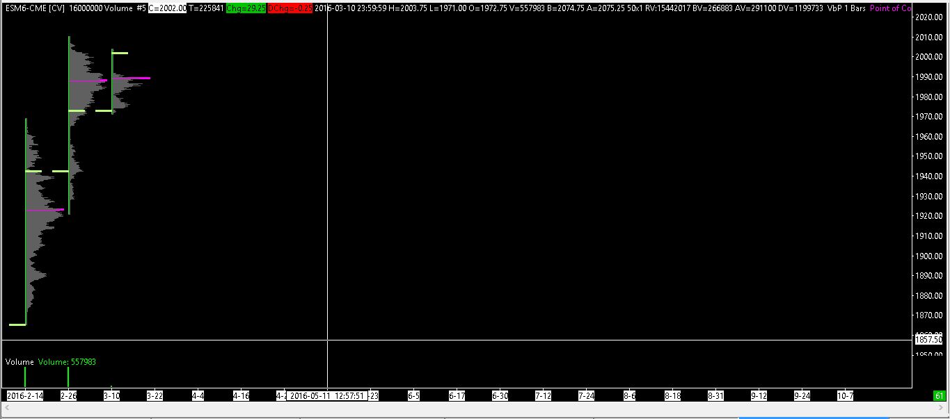

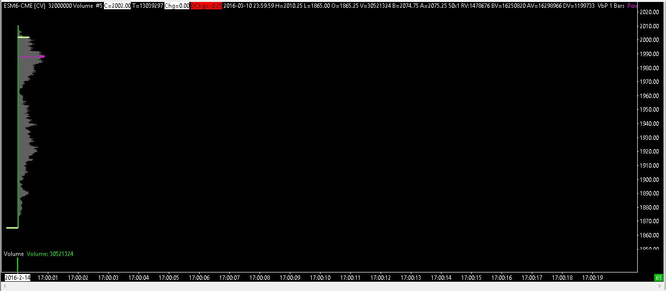

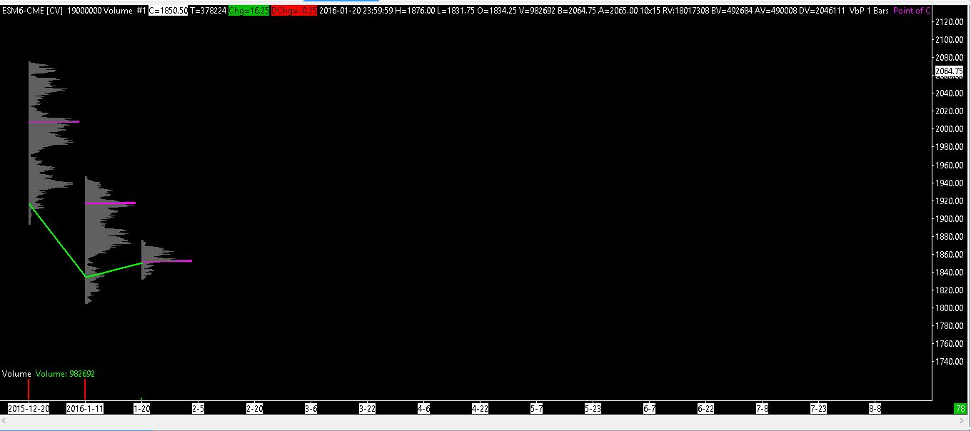

I set Volume per bar period with 19 000 000 as volume and get 3 bars (2 of 19M and 1 of 982K, see pic1 and pic2). Then I change volume with 38 000 000 and get 1 bar (35705K, see pic3 and pic 4). Why I don't get 2 bars 38mln + 982K?
imagepic1.jpg / V - Attached On 2016-04-03 14:51:11 UTC - Size: 150.01 KB - 443 views
imagepic2.jpg / V - Attached On 2016-04-03 14:51:21 UTC - Size: 61.17 KB - 434 views
imagepic3.jpg / V - Attached On 2016-04-03 14:51:35 UTC - Size: 149.66 KB - 438 views
imagepic4.jpg / V - Attached On 2016-04-03 14:51:55 UTC - Size: 60.68 KB - 418 views

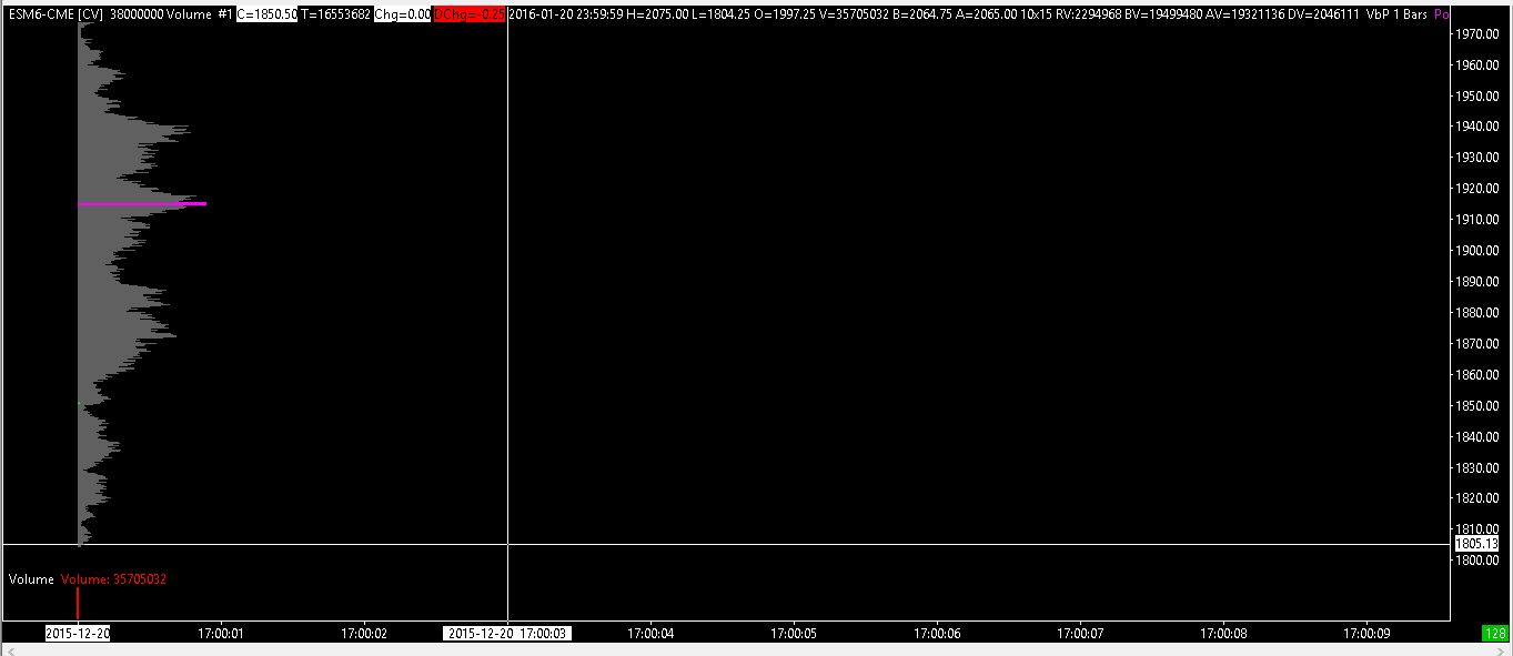

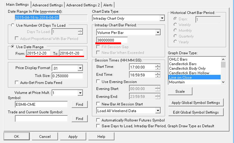

Update and download do not help. I resolve this problem with rewriting data files from my other computer. But in last es-mini contract I can't resolve it in any way!! I notice, that problem appears if bar takes more than 14 days. Any suggestions??
imagePict1.jpg / V - Attached On 2016-04-15 21:18:38 UTC - Size: 143.81 KB - 385 views
imagePict2.jpg / V - Attached On 2016-04-15 21:18:45 UTC - Size: 65.86 KB - 438 views
imagePict3.jpg / V - Attached On 2016-04-15 21:18:51 UTC - Size: 150.71 KB - 504 views
imagePict4.jpg / V - Attached On 2016-04-15 21:18:54 UTC - Size: 57.48 KB - 386 views
